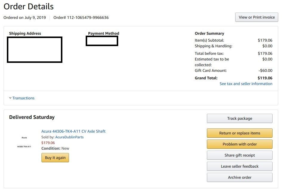

Originally Posted by TheSauceBoss
Do you have a 6MT? That is insanely cheap for a true OEM axle. I know the six speed ones are cheaper for some reason, but OEM 5AT axles are $500 a pop.
Originally Posted by zeta
Just curious.
losiglow, when you get your 'OEM' axle from Amazon, if possible, take a few pictures of the axle and the box it came in.
There is a question, amongst some of the forum members, as to whether it is 'authentic' OEM or perhaps a counterfeit boxed in 'knock off' Honda packaging?
Sorry, don't mean to cloud the thread with 4G stuff. The same issue kind of applies and the drivetrain is nearly identical so I was hoping to get some insight. But yes, it appears prices are quite a bit higher for 3G axles than 4G. Presumably due to age.
I neglected to mention that I had a $60 credit, so the actual price was $180.
It looks like they've raised the price to $202. It's from Dublin Acura. Not sure where they're located exactly:
Amazon Amazon
Amazon Amazon
Came in the same standard Honda box that my passenger side came in. Pretty sure it's legit. Unfortunately it didn't eliminate the vibration at higher speeds though. It seems to have reduced it a bit but I think that's just placebo. I'm heading back in to Discount Tire today to have them take another look at my wheel balance.
https://www.amazon.com/gp/product/B0...?ie=UTF8&psc=1
https://www.amazon.com/s?me=A2BFVY0M...=ATVPDKIKX0DER
losiglow, thanks for your detailed response above.
When I google the name 'AcuraDublinParts' on Amazon, I get Acura of Columbus; 4340 W Dublin Granville Rd, Dublin, OH 43017. You mention that the axle came in a 'standard Honda box', as one would expect when purchasing from a 'legit' Acura/Honda vendor online proving there are 'true blue' dealerships on Amazon contrary to what is alluded to below from another thread. There may not be such a thing as a 'Honda Store' on Amazon; however, there may be individual Honda / Acura dealerships that sell said OEM parts.
Originally Posted by t-rd
There are many 3rd party vendors on Amazon, that's not of Amazon directly. There are actually parts sold on Amazon, the seller shown as "Honda". I spoke to my local Honda dealer directly, at the counter, there is no such thing as a Honda store on Amazon. Honda sells parts directly online privately dealer by dealer, they source parts from Honda's local warehouses or directly from Marysville, Ohio. You don't know what you are buying until you get a counterfeit part, just like I did.
I actually used to work at the Acura Columbus in Dublin, here in Ohio. It's only a few mins from where I live now. Though it's located in Dublin, I couldn't see them using that as an Amazon marketplace username...which is strange. Either way, I can text my buddy that works parts there and ask if they're pushing stuff out on amazon. The only reason I can see it being in a Honda box is that the part came directly from the manufacturing plant up the highway in Marysville, and they didn't bother rebranding it. I'll let you know what I find out.

I misunderstood your box question but regardless, my buddy said that was indeed their amazon account, so all of those parts are true OEM from the dealership in Columbus.
