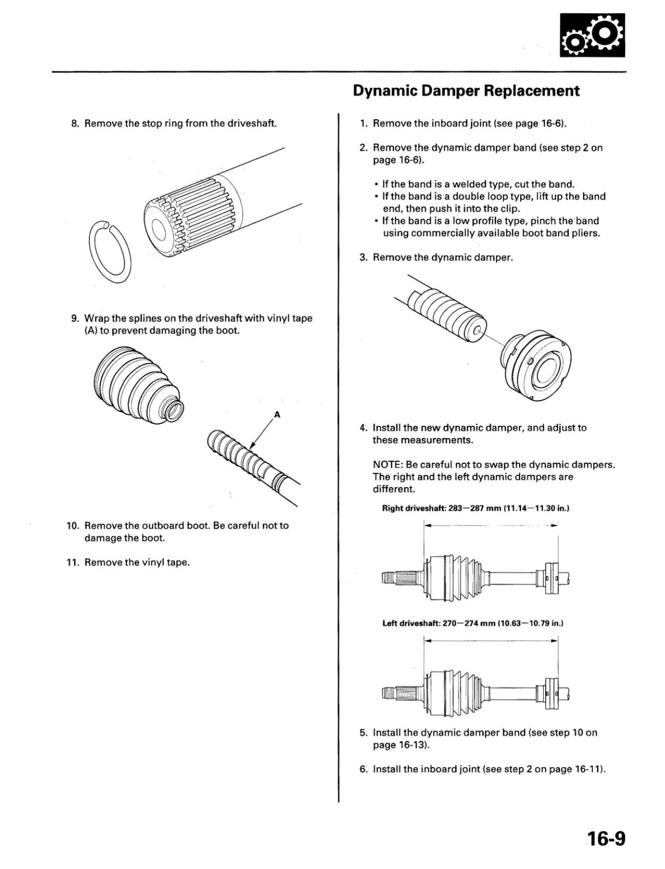

https://www.acuraoemparts.com/v-2007...aft-half-shaft
#17 - 44351-SEP-A11 - Damper, Dynamic - $12.62

Problem with the OEM damper is that it traps moisture and causes rusting!
