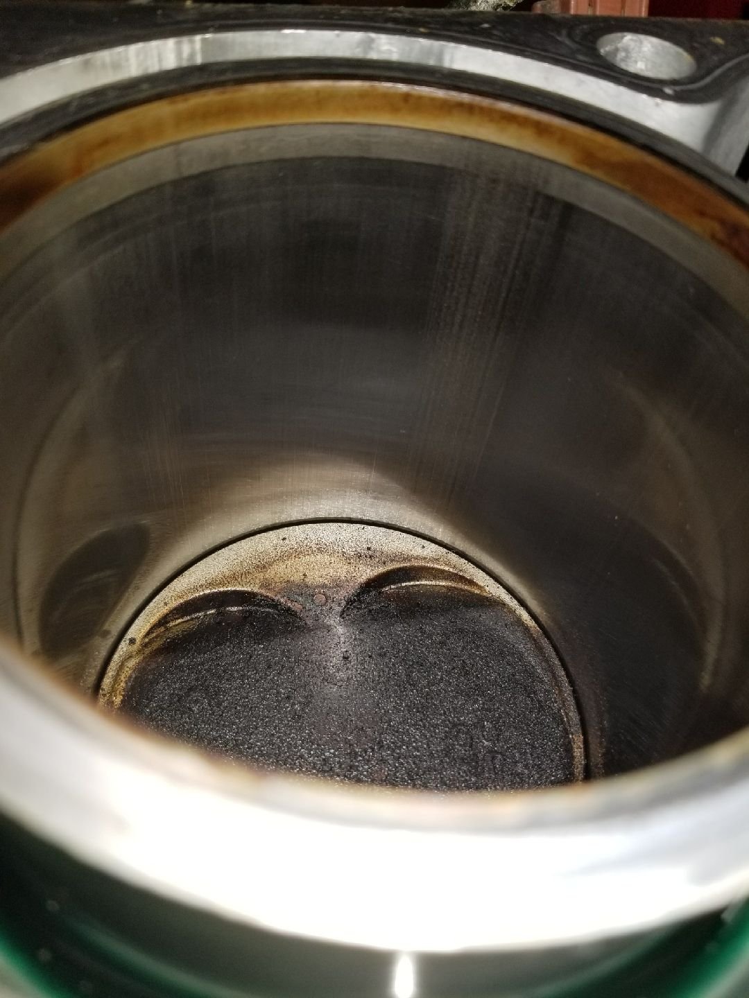

Borescope is pretty definitive. Given how generally robust the J35 engine is, I'd love to know how those cylinder walls got scored; unfortunately that is something we'll probably never figure out.
What do you think about theory that cylinder walls were scored by failed precat debris back flowing in to engine?

That should never happen unless the timing was all screwed up (which presents its own failure modes).

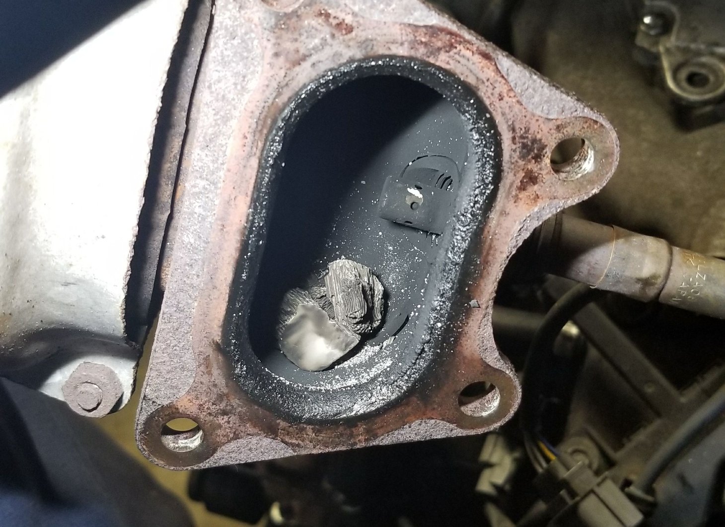

Here is a pic inside the front precat.

Thanks. It is actually looking like the precats may be the culprit. Thought I posted some pics but apparently did not work. Will try again.

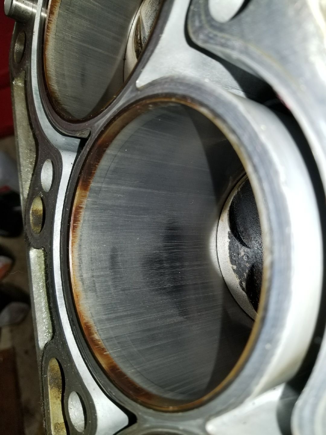

Here are 2 pictures of MTylers rear (bank 1) precat. All bank 1 cylinder walls show signs of scoring though cylinder 5 looked to be the worst from the borescope. Funny because cylinder 5 is the straightest shot out or possibly back in of the cylinder head. Also these are the original precats (230k) and were reused after the original engine failure . There had been a p0420 (bank 1 converter efficiency below threshold) but was turned off some time ago with hondata.

Cylinder #5

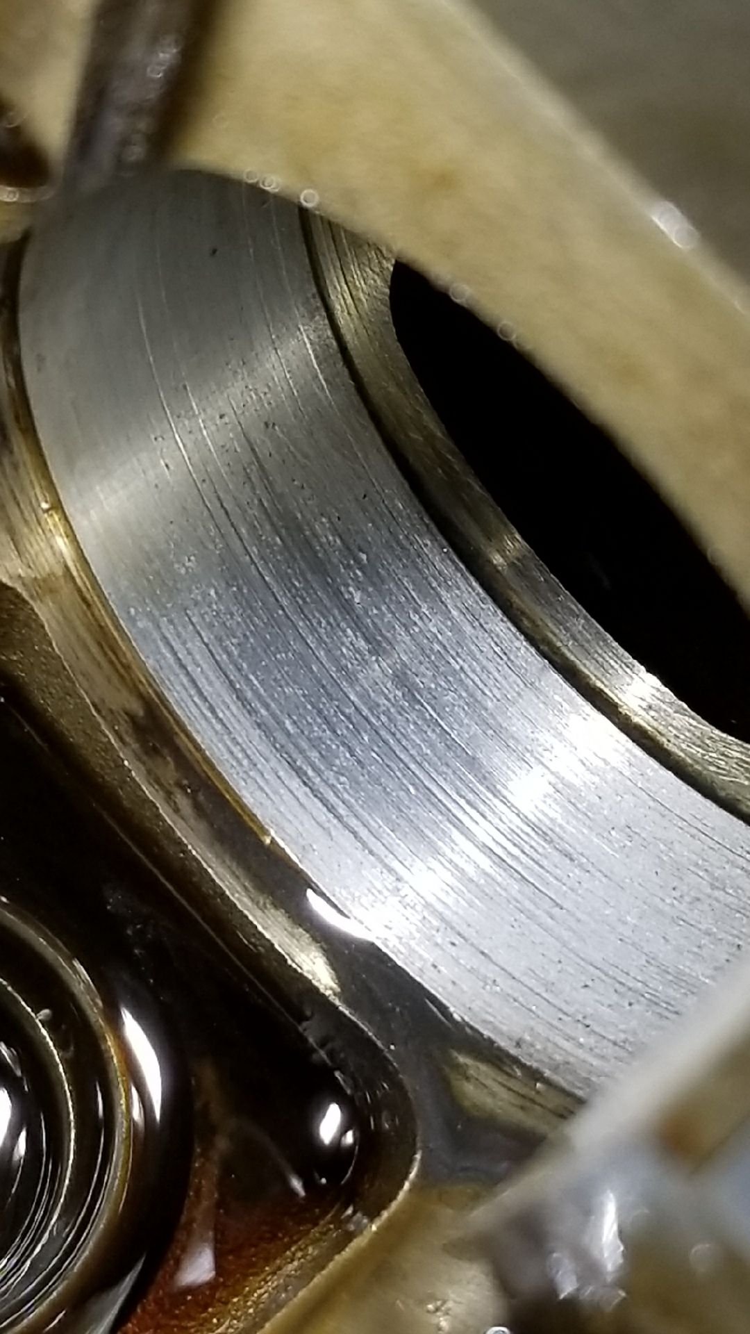

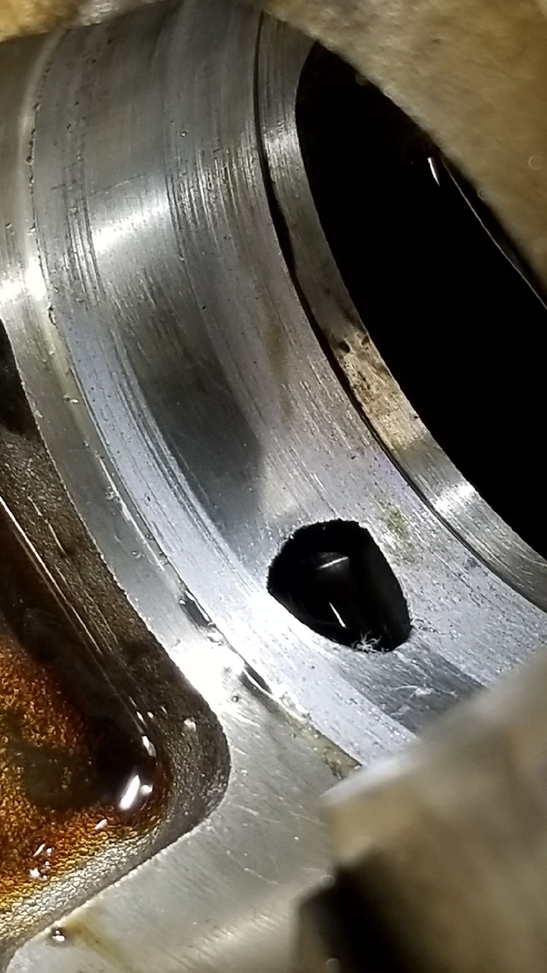

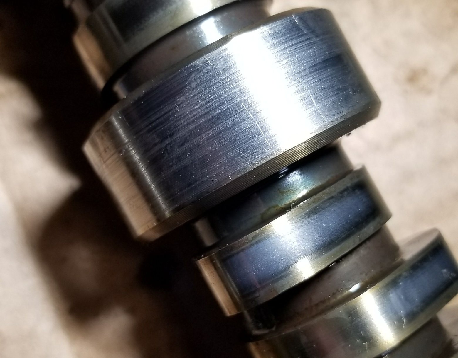

Heads were taken apart and cam shafts and journals were found to be scored. Hoping cam shafts can be polished. Assuming journals too badly damaged and will need to buy a used rear head. I have front head still from my first J35A8.
Cylinder Head Journal
Another journal
Camshaft

I'm certainly no expert, but that damage seems consistent with either low oil, dirty old high mileage oil, or oil starvation due to sludge build up from dirty old high mileage oil. Once the damage is done, there is no turning back. I think you said the engine had 75K on it when you got it (or something like that). Who knows what neglect that motor went through early on?
You could be right that there was pre existing damage on the swapped in engine. I never ran it with low or old oil for the 80k miles I put on it.
Definitely hearing more and more instances of Honda engines with cats directly adjacent to the exhaust manifolds failing and causing severe engine damage. Also not an expert on the issue but it seems like it would have been better design to not have these two cats that run so hot located in the engine bay and immediately next to the engine so that if they do fall apart they cannot cause such significant damage.
PCDs.

Yea I've heard a few horror stories..
As for the J35Z6, use your harness and swap over your oil pump (or new), crank sensor/gear, plus accessories.
Would also need the newer style pre cats.
