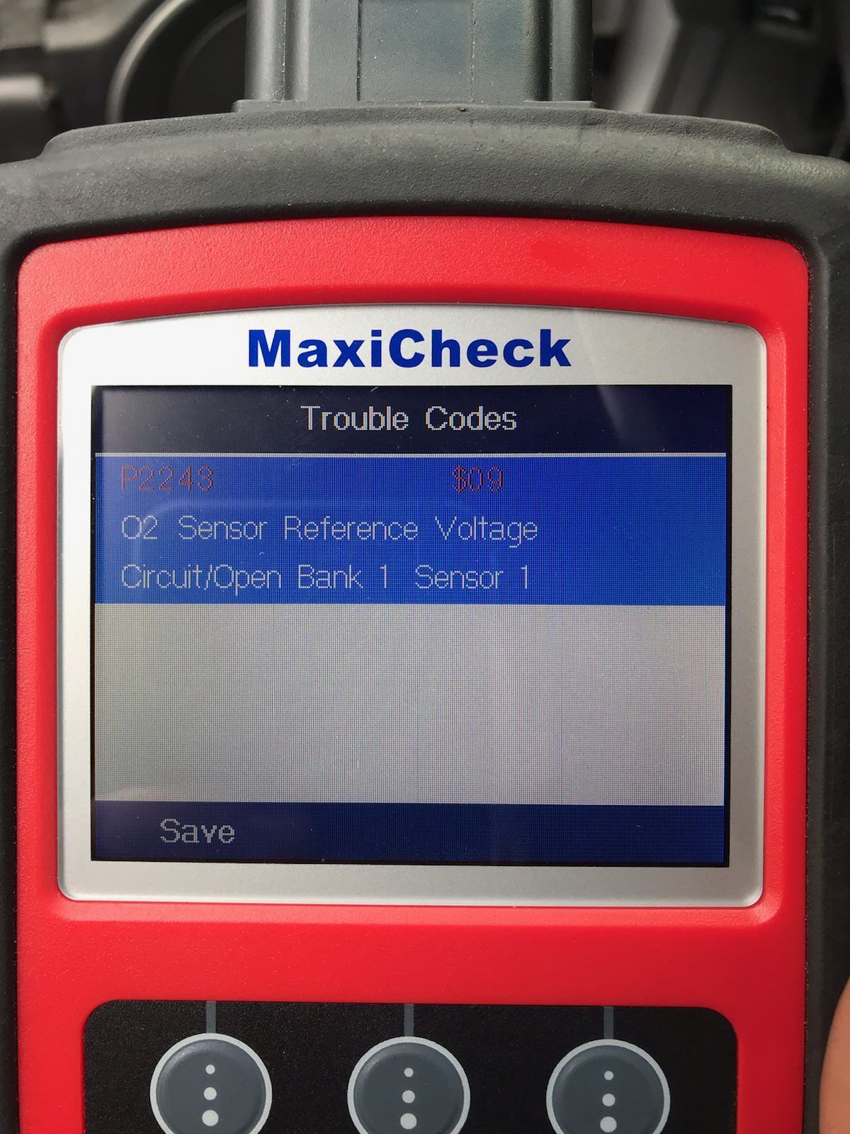

Hey guys. I got an engine light and the sensor reader showed this... now i want to ask you guys if this is the right part for it that i found on this site. Ill attack the pics here both the part and co
de reader.

That's it.
First, clear the code and see if it returns.

Replace with a Denso A/F sensor and call it a day.

He means, don't buy any of those brands listed. Buy Denso brand.
