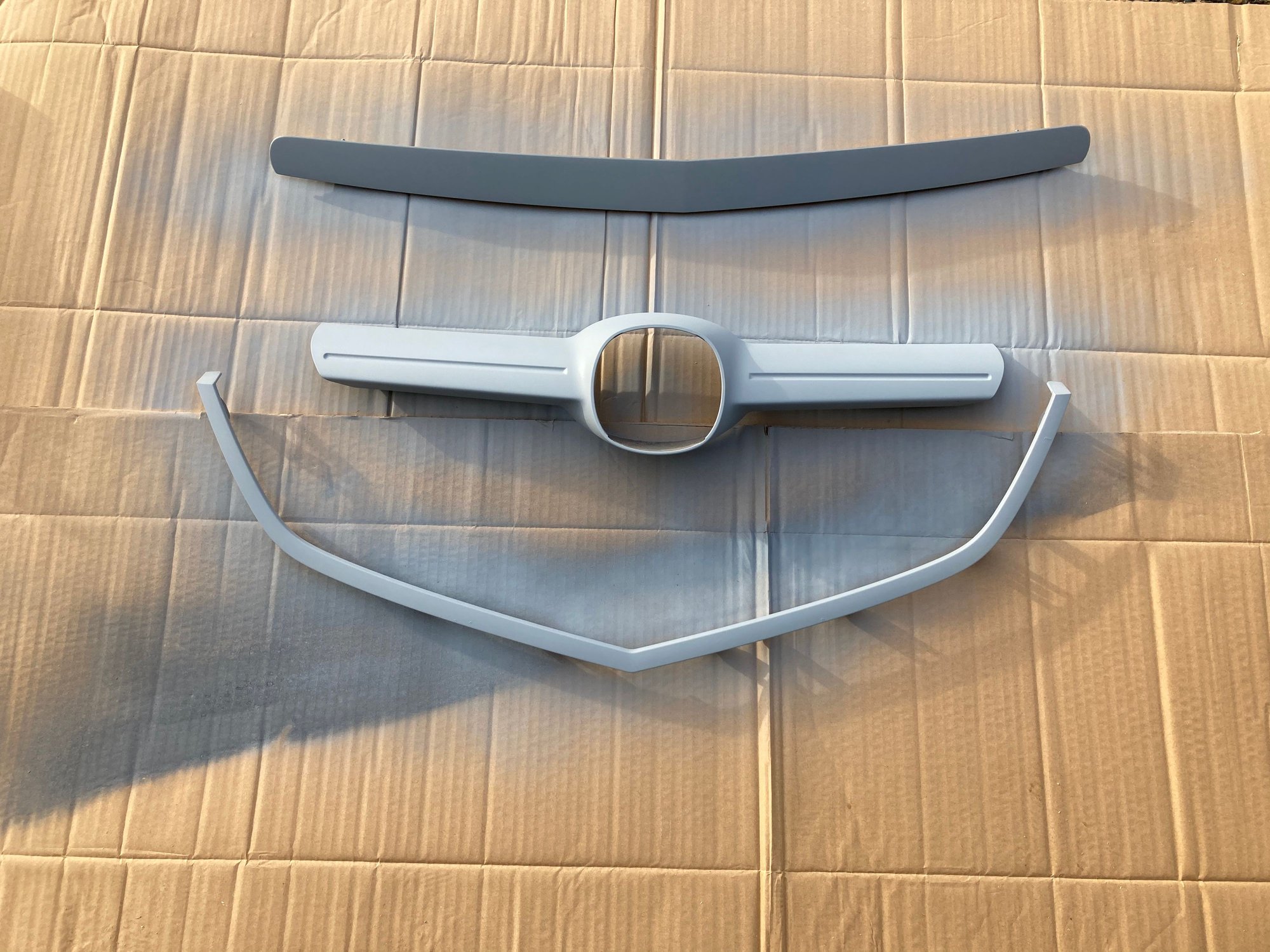

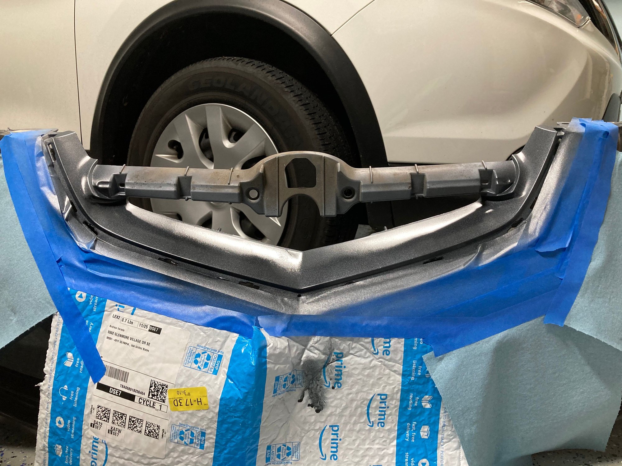

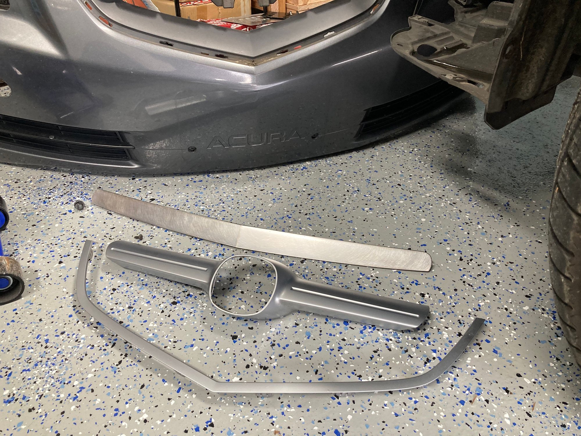

I ordered an aerosol paint touch up paint kit from scratches happen. The kit comes with primer, color matched base coat, and a clear coat.
I disassembled the bumper and grill parts, and masked off the bumper.
Applied 2 coats of each spray, quick drying with a hair dryer between coats.
I still have plenty of paint left in case I have a need to color match anything else in the future. The color match is pretty good, but I think I will need to wetsand and polish the clear coat to match the glossiness of the factory paint. Overall it was easy, and I recommend the product.

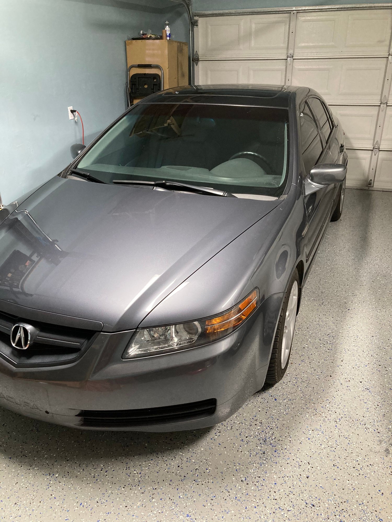

Looks great, just like your garage floor!
Old Nov 29, 2020 | 02:32 PM
Aharada's Avatar
Joined: Oct 2020
Posts: 13
Thanks! I did that earlier this year using Rustoleum Epoxyshield Professional (Professional version is solvent based as opposed to the water based home store version). It has been great so far.
