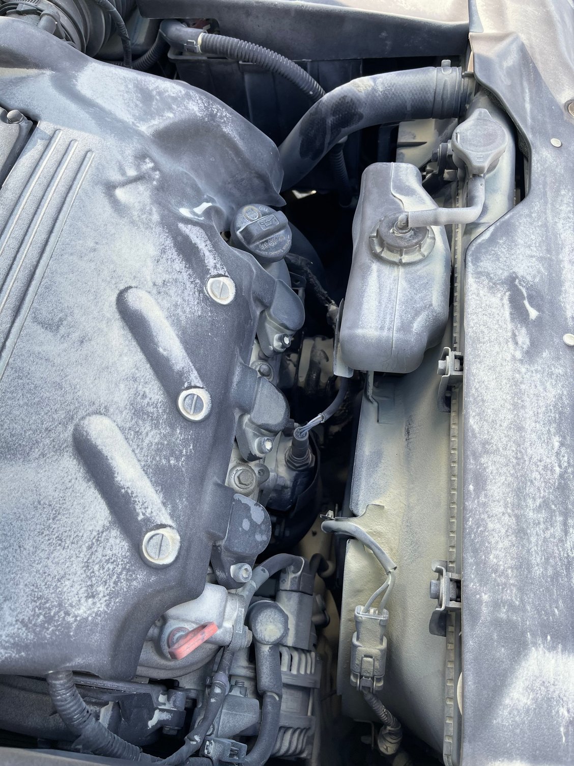

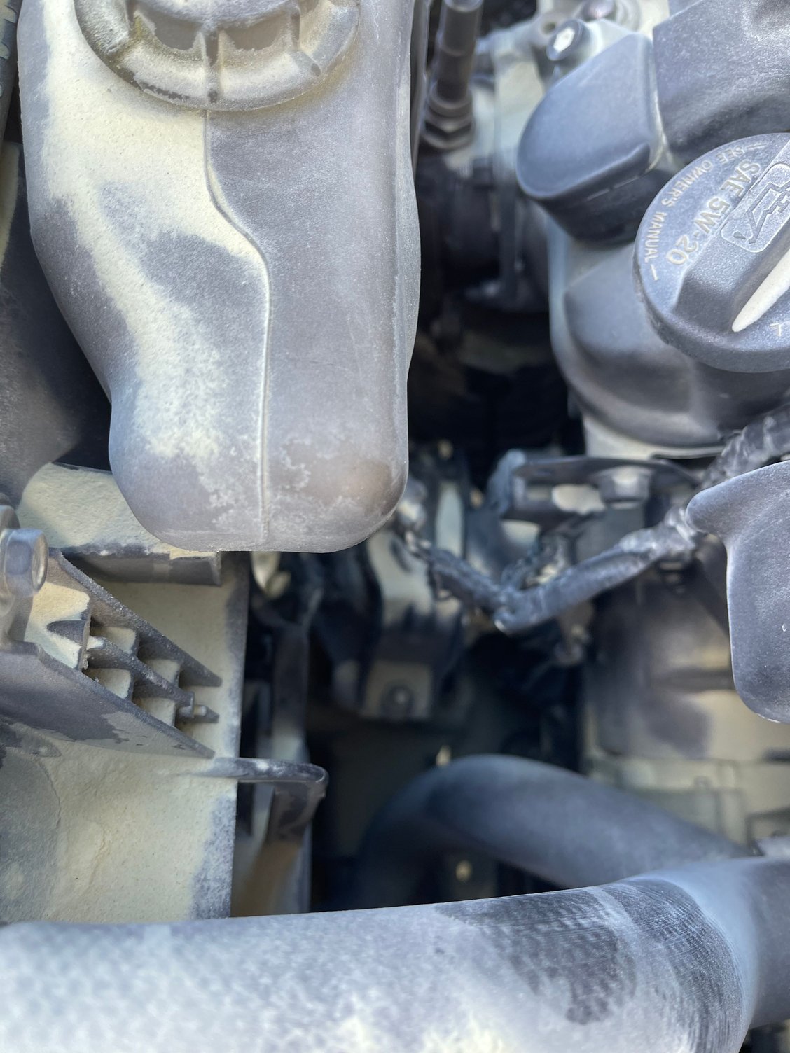

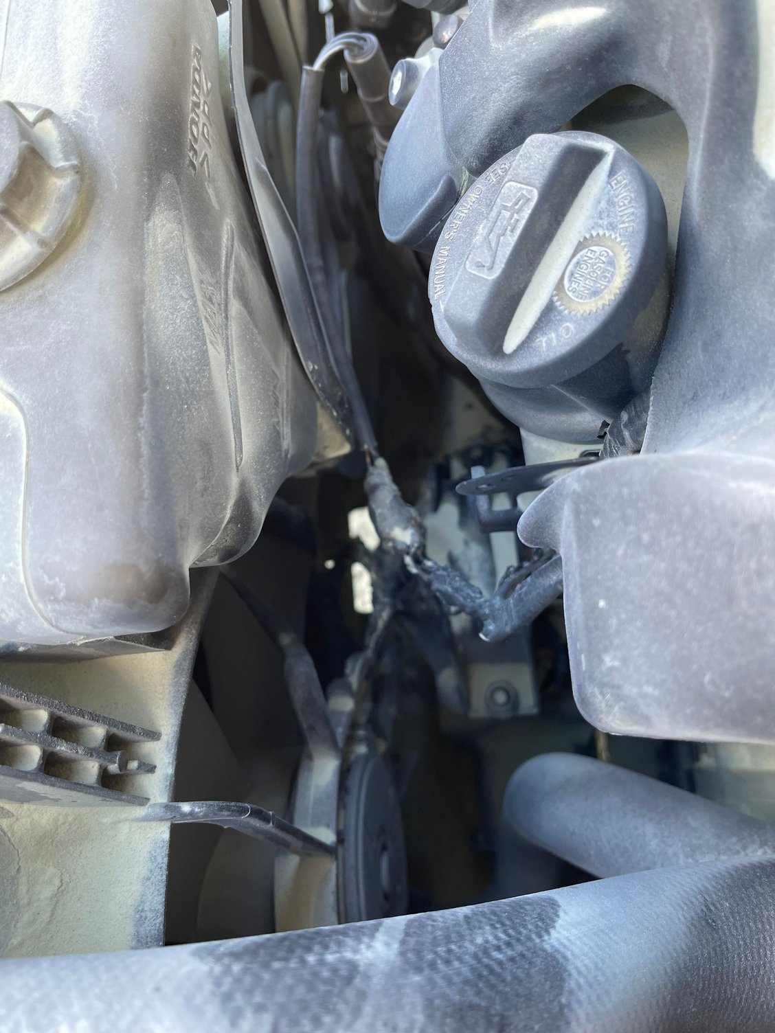

On March 8, I took it in for a standard oil change and a transmission drain and refill. Left the shop and smelled burning oil. I figured they just spilled a little on the manifolds and it would burn off (it did). Yesterday I was driving home and smelled burning electrical. Pulled over and could see smoke coming out of the hood. Opened the hood and was greeted with flames pouring out of the front of the engine. Grabbed my extinguisher and put out the fire. Called my wife to bring my truck down and towed the car back to my house.
Upon further inspection, it looks like this fire started with the wiring running to the cooling fans on the radiator. I had the owner of the oil change shop come out and we visually inspected everything, it does not look like oil on anything.
Has anybody heard of an issue like this? Looks like it will need a new wiring harness to the injectors, O2 sensor, fan back to the fuse box, new radiator fan, and a new motor mount. However, I want to make sure this never happens again. The car will start and there is no check engine lights, the fan also runs which is also puzzling.

that is so weird. it does look like the harness was the source of the fire from what i can see in the pictures. im no expert though
most of the engine fires posts here are related to the power steering hose

I’ll try to get better pics when I start taking it apart.

wouldn't be surprised if they spilled oil while filling and used something like brake cleaner to clean the area. Brake cleaner will eat through the protective coating on wires. Once the 2 wires touch on exposed areas, it creates a short circuit (lots of heat) and eventually fire. Call your ins co or look at LKQ/U-Pull it for replacement parts.
