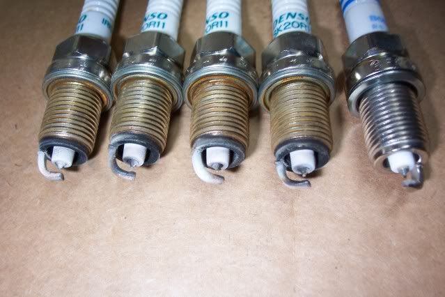

It's perfectly normal to have a thin film of buildup. Like this:
But if it's black or sooty, then you're probably running rich or burning a lot of oil. If they look like the plugs above, just leave them alone. At most, soak them in a bit of gasoline then use a nylon brush (not steel) to clean them.
