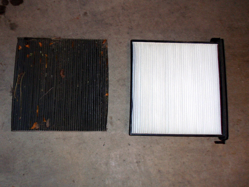

All right, the most basic of the stuff I needed to do was taken care of today. That and I took apart the entire center console again and tested a different head unit (since my Navi doesn't play the voice through the working one that I got, to no avail), and that took up most of my time.
I DID go out and buy all of my fluids (except brake fluid) today. What I decided on was the following:
Royal Purple 5W-30 oil
Royal Purple filter
Honda ATF-Z1
Honda PS
Honda coolant (type 2- the blue kind)
Purolator air filter (unfortunately, northern Utah isn't exactly a happenin' place, so only Pep Boys an hour away was the only store within an hour radius that had one that fit my car. And only one in stock, at that)
Changed out the oil and filter, which of course was easy, and I found that miraculously enough, my coolant level is actually mid-level (not below minimum, as I had seen before) and my power steering fluid is totally full, which was definitely NOT the case a few weeks ago.
The only explanation I can think of is that when I went to the dealer in Salt Lake last Friday they topped off my PS and added some coolant, but they sure as heck didn't tell me about it.
Oh well, saves me buying fluids later I guess. I'll still take care of that stuff come February or so.
In the meantime, I wanted to post this specifically because I think I have everyone else beat.
You know that thread that says "for God's sakes, people, please change your air filter!"? In that thread a disgusting air filter was posted, and it was the worst most people had seen.
Today, I have raised (or rather, lowered) the bar for nasty air filters. I could not shine a flashlight through it. At all. Not even a hint of light. Very bad.
In my defense, 1) I took care of it and 2) I have only owned the car since the end of September so kudos to the previous owners for being so proactive with maintenance.
And here is the monster itself:
I can now sleep at night knowing that I have dodged the cancer bullet any time I inhale in my TL.
Sweet dreams! More fun pictures when the other stuff gets done.

that is one butt ugly filter. lol The last owner must have been going biological weapon in his car. lol

Wow, I have never seen a filter that dirty in my life. Good thing you replaced it. As a couple members on here recommended, the charcoal activated filter is probably better. Rockauto.com is the place to buy them.

Air filter- Factory filters are the best by a long shot. They're a 3 stage filter, starting with oil then fiber and then paper. The seals are a long lasting pliable rubber. Many of the autoparts store filters end up with rotted seals which let dirt through. Acura put a great air filter in these cars so I would not use anything inferior and that especially includes K&Ns if you plan on running the miles up on it.
