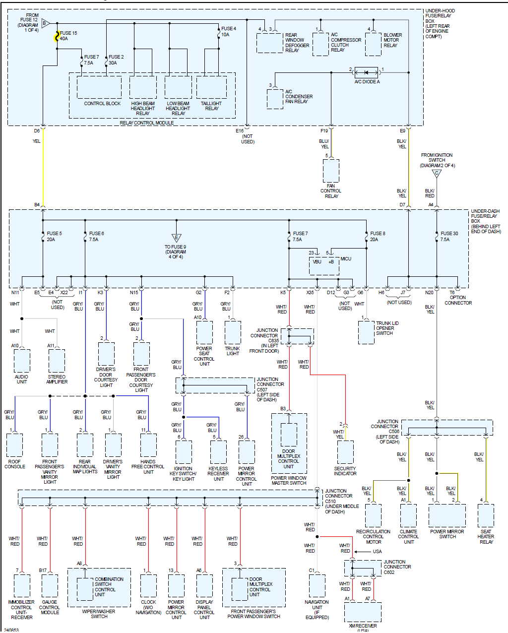

2006 TL battery will die if sitting for a couple days. Using test light, found the draw to be coming from the fuse #15 under the hood, because the negative terminal ceases to have current pass through it when I pull that fuse. I found online that this fuse powers the driver's side door panel fuses 5, 6, 7, 8, & 9. However, when I pull each of these out individually (with #15 still in) there is still a draw in my test light. So I'm not sure where to go from here. I also replaced the AC relay under the hood, still have a draw.
Any ideas on how to diagnose further and solve this issue? Thanks!

Pull each fuse that under-hood #15 feeds. There are couple relays as well but I doubt it's any of the lights relay. Don't use test light to measure current!!! There is no way to accurately measure anything with it. Either use voltmeter to check voltage drop across each fuse or amp clamp to measure total current.

Hands free link disconnected? It's behind center / rear vents if memory serves me

Bluetooth module that goes bad in like all of the Acuras.
Of course I'm just guessing. No way to know for sure without checking. Also I guess I was thinking about next generation of MDX to yours. Seems '06 have it around dome lights.
