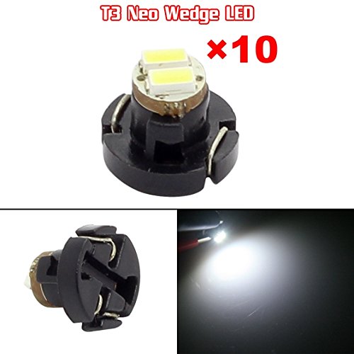

Yeah, doing research will definitely help. I would just like to point out that some (not all) T3 neo wedge bulbs can be bought already attached to a housing and have load resistors already soldered underneath the led bulb (See attached images):
The black resistor is underneath the LED bulb (i.e.hidden) if you can picture this. The resistor s extremely small and is typically attached by a robotic soldering machine. You can find these types of bulbs all over ebay and I have used these for over 20+ LED modifications without any issues. If you want to solder an LED to a circuit board, you can just "unwind" the LED prongs and take off the plastic housing. It's pretty easy once you do a few.. If you ask, I'm sure there are more reputable vendors out there, but ebay has worked for me thus far.
