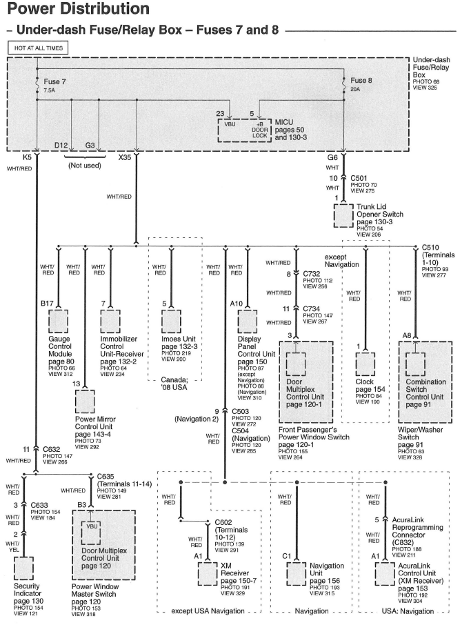

Happy new year folks, I experienced dead batteries recently and I found I have a 600mA parasitic draw. I replaced the battery yesterday, and while its more healthy, the issue still persists.
2006 3.2L Base, w/ Navi in Canada (No XM)
-took out the HFL connector, and solved 1/3 of the issue. Its now 400mA draw. HFL was drawing about 200mA.
Fuse #7 is the main culprit, drawing about 340-360mA. 90% of my issue, but no idea whats the issue. The functions listed for it in the pic below work fine. MICU might be the issue, but apparently the underhood fuse IS the MICU. Any fixes for this one?
Fuse #6 under the dash is giving me a 40-60mA draw. Its not horrible, and probably can live with it since its like 10% of the remaining issue, but seems easier to fix than my # 7.

Is the above accurate in terms of what the fuses control? I have not seen any other source list specific functions like the one above. Simply interior lights, or backup.

I just finished tracing & troubleshooting where my #7 interior fuse draw was coming from, so I know the pain that you're dealing with. I only had a dead battery 1) in the colder months, AND 2) I didn't drive the car for more than 2 days.
I systematically took the interior apart so that I could disconnect each individual component that #7 powers; gauge cluster, wiper stalk, drivers door card (for power window and power mirror controls), pass door card, clock, radio/navigation unit, XM unit etc, and drove to work for a week with the center console, dash, trunk, and everything else completely torn apart. By individually unplugging each component separately and watching the DMM, I found once I unplugged my XM receiver/control unit (just AcuraLink control unit, in your case) my draw dropped from ~.400amps down to about .035amps. Sucks, because I LOVE XM radio. If you're suspecting it's the navigation unit, no, simply ejecting the DVD will not be sufficient enough. You'll need to disconnect the entire unit.

And the #7 fuse controls -
Acuralink control unit (XM receiver) (USA: Navigation),
Clock (except Navigation),
Combination switch control unit,
Display panel control unit,
Front passenger’s power window switch (Door multiplex control unit),
Gauge control module,
Immobilizer control unit-receiver,
lmoes unit (Canada; ’08 USA),
MICU,
Navigation unit (Navigation),
Power mirror control unit,
Power window master switch (Door multiplex control unit),
Security indicator,
Wiper/washer switch,
XM receiver (except USA Navigation)
