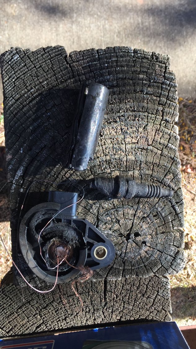

Sorry I forgot to take pics before dropping the car off. I will try to take some pics when I go back.
The mechanic is taking the head off to inspect enough aluminum is available to rethread and to check the interior to make sure rethread will fix it.

1. Was the plug totally out by itself or did someone pull it?
2. Was the "metal" on the threaded end?
3. Do you still have the plug? If so, post a picture.
A good mechanic should be able to do a time sert with the head on the car... I hope he's not charging you a ton for head removal/replacement....
Also, a good mechanic could scope and vacuum the cylinder without having to remove the head. Who is this guy?

The plug came out completely and the metal was on the threaded part of the plug.
The plug and coil is inside a box in the car. i will definitely take pictures once I go back to the mechanic.

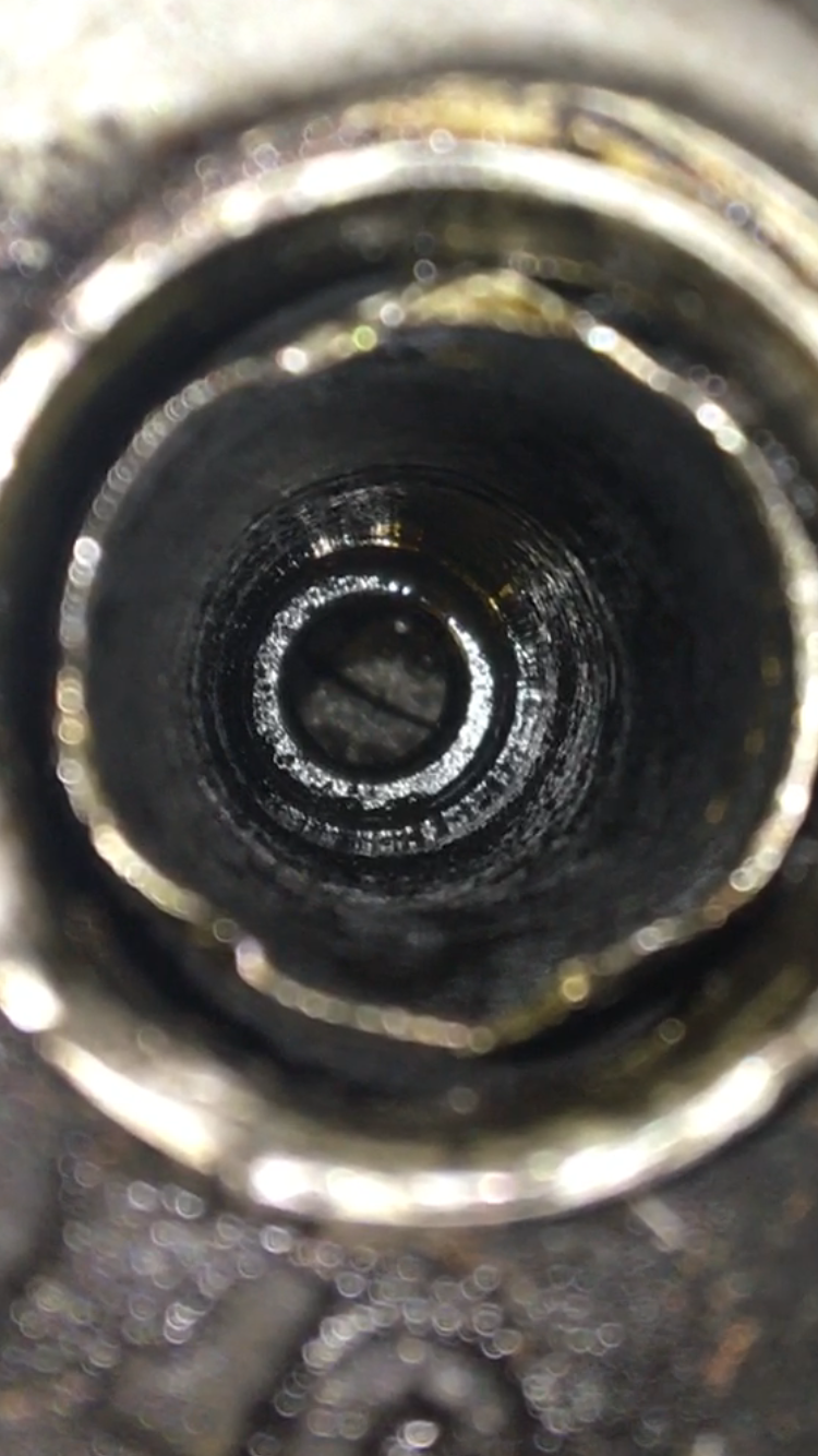

Guys here are some pics I had on my phone of the hole after the plug was taken out

Wait, how'd you manage to take those pictures? Is this at the front or back of the engine?
Hey I was able to get pics of the part from my friend he had on his phone. See the attachment and thank you for all your help man
He said he will only charge me $250 tear the engine apart and inspect everything to make sure if I need to overhaul the engine.
As far as the repair cost goes, when I dropped the car off he said $2500-3000 roughly to do everything but I called him today and told him I would rather try to rethread the hole and put a new plug and see how it drives.
He's a mechanic whom I have been going to for couple years now, and he's been a honest guy but for some reason I feel like he's charging me bit more than before.
It's my fault for not trying to put a new plug before towing it.
Also I made a mistake in my response, the plug had to be pulled out by the shop my friend had taken to after this happened.

Hard to be certain, but I don't see any "metal" in the plug threads. He may be in luck as it looks like maybe the plug just came out/loose. The heat melted the coil making it a bitch to get both the coil and plug out of the spark plug tube. I'm surprised the plug wasn't blown completely out.
When they pulled the plug, did they actually have to unthread it, or did it just come straight out?
Old Nov 13, 2016 | 10:02 PM
YungMoola15's Avatar
Joined: Feb 2014
Posts: 383
Likes: 17
From: Northern Virginia
I am not sure about how it was taken out but pretty certain it was hard to do.
What is the thing around the plug on the threaded part? I thought that was metal?
I had a video in my phone when I went to check it out I was trying to get a good look inside with my phone since I don't have a borescope.
