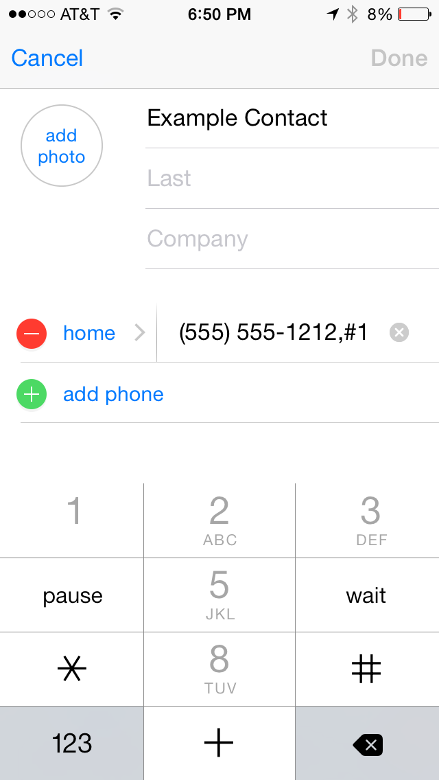

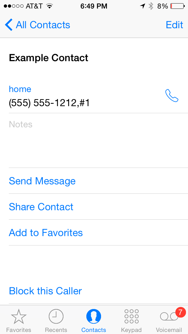

Not sure I'm following you. Do you mean the iPhone 5s when you refer to "handset"? Cause if so, the pause function is definitely there. I too have an iPhone 5s, running IOS 8.1.3 and it allows you to insert "pauses" or "waits" into the string of any phone entry in an address book contact. See pics below:
Example Contact
Contact String Editor
If you create a contact in your iPhone in the manner shown above, then the RLX NAV HFL system will have no problem dialing the number, waiting till the call is established, and then proceeding with the additional characters in the string (in the example above, the #1). I tried this 5 times with my voicemail inbox at work and worked flawless each time. The key is to insert the "pause" after the full number. This creates the comma you see in the string. Then you enter in the rest of the digits you need to navigate your voicemail system.
With this method I was also able to just use the "voice" command in the RLX to say "dial Example Contact" and it dialed the address book entry for me, and the string worked as expected.

There is also a "pause" button on the RLX dialer screen, and it works just like the iPhone does. Did you try that?

it works for just about anything that requires additional string entries (eg GotoAssist, WEBEX, etc etc)
The key is to insert the "pause".
And it is not specific to the iPhone. The "pause" function is right there in the RLX phone dialer screen. It's the "P" button at the bottom of the dialer. Works exactly the same.
