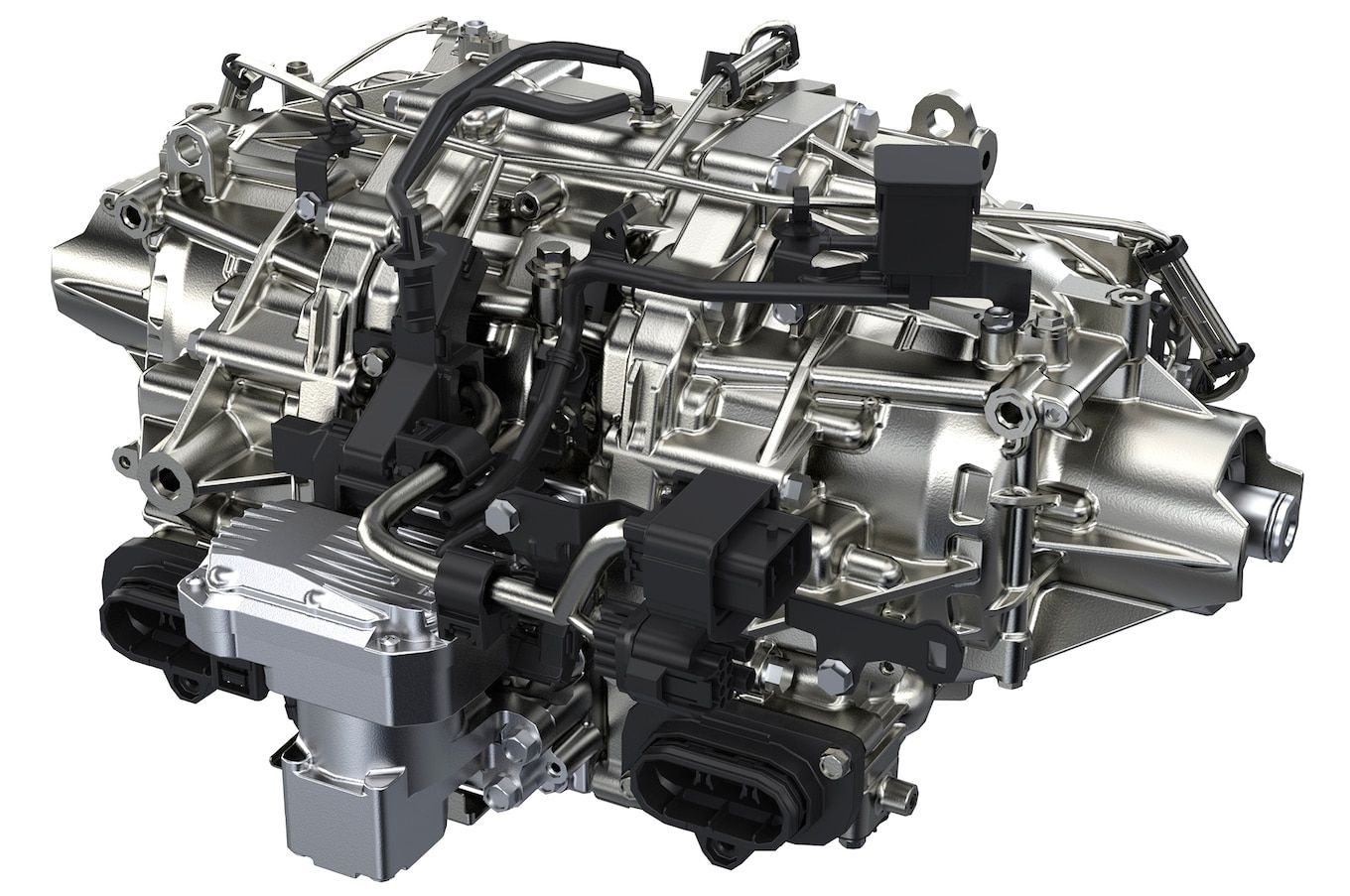

No, there isn't. The two rear motors are not connected to each other or to the front motors, and if the two rear motors are supposed to be pushing equally, they rely on the computer programing to decide the torque differential. :-)

OK so that leaves me wondering what the Twin Motor Unit does. Since, I think, there's only one of them does it drive the two rear motor through separate shafts, and if it doesn't, what's its function and how do the two rear motors get driven??

It doesn’t “do” anything. It just just a housing.

The twin motors are just that motors. Each one drives one wheel independently as well as recaptures energy when coasting, turning or braking. It will send power or recapture energy independently of each other to enhance performance and stability. The front motor is sandwiched between the DCT transmission and the ICE engine and provides both positive performance and regenerative capture too. It is a very slick system and the performance overall is amazing. Very unusual overall.

Yes, I got more info from my service manager.
The front is powered and controlled by the ATF as we would suspect, and the service interval for fluid change on the ATF is "generally" 30K miles.
That big honker "case" that George showed us drives the rear two wheels (as well as recapture, etc., etc.). Now I was told it is produced and sold with "break in" fluid that "generally" gets changed at 15K miles and replaced with the ATF stuff. After that change interval is "generally" 30K miles.
