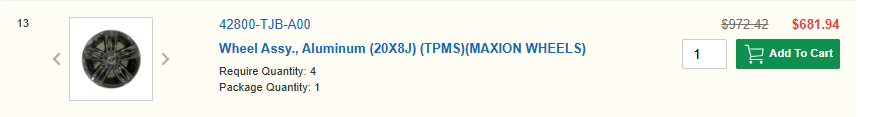

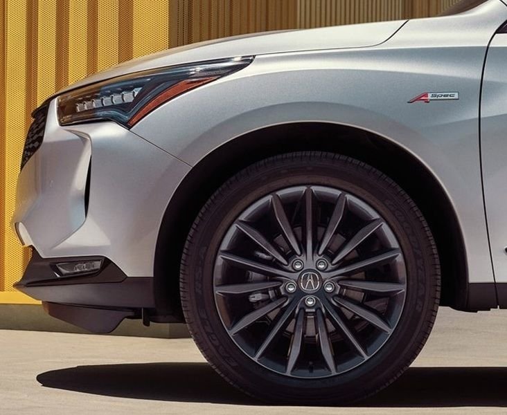

I have been looking for a set of the A-spec Advance OEM 20" wheels, the skinny 15 spokes version. I found a place online that sells used (good condition) OEM wheels and they have the wheels that I have been looking for, but the part # they have listed seems like it's not the correct part # for it so I just wanted to see if ya'll can take a look at it and confirm that the wheels they are selling are the 15 spokes version that comes with the A-spec Advance RDX. The part # they have listed for is for the A-spec RDX and not the A-spec Advance. See link -- https://www.originalwheels.com/shop/...spLb4C4l5aaMnQ
For reference, these are the wheels I am talking about.

The part number 42800TJBA00 below on the website you provide does not appear to be associated with the 'image' provided below.
The 2021 RDX A-Spec (SH-AWD) #13 42800-TJB-A00 wheel graphic below does not look anything like your original picture above or the website picture?
Therefore, the wheel you desire is either year 2024; 42800-TJB-A20 OR 2025; 42700-TJB-A51, not 2021; 42800-TJB-A00?

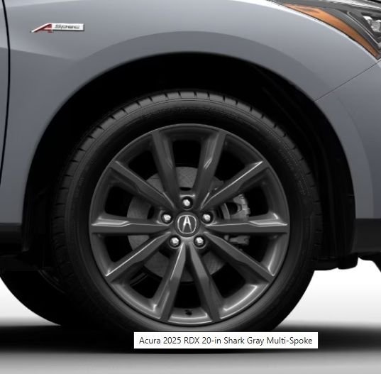

I'm not sure if this is still an on-going concern/ask but the pics of the desired 'spoke' wheel above look to me like the 2025 "A-Spec" wheel (20" shark gray).
The 2025 "A-Spec Advance" wheel is the same physical wheel (I think) but with a different paint scheme (Berlina Black and machine finish vs shark gray).

Totally re-verify the info but here's my own research:

Middle pic above - "A-Spec" package - 42800-TJB-A30
  • Cross-ref'd w/ DreamShop info:
  • Wheel Assy., Aluminum (20X8J) (RESONATOR)(MAXION WHEELS)
  • Part Number: 42800-TJB-A30
  • 10 spokes

None of my pics/info above apply to the wheel you're looking for.
I see for model year 2023, the A-Spec Advanced wheel looks to be the one you're after (20" w/ 14 spokes). I think this is what "Zeta" pointed to above:
  • Wheel Assy., Aluminum (20X8J) (TPMS) (ENKEI)
  • Part Number: 42800-TJB-A20
  • 15 spokes
I've run into similar issues where the photo isn't accurate to what is shipped, nor the part numbers listed. And the sellers put in disclaimers, 'not responsible for mistakes,' etc.
I'd ask for photos of the exact object/wheels they're going to send you because the part number they provided do not match the photo.
Even if they allow returns, the shipping costs to return wheels is super-expensive.
Good luck ... keep us posted.

I see for model year 2023, the A-Spec Advanced wheel looks to be the one you're after (20" w/ 15 spokes). I think this is what "Zeta" pointed to above:
  • 15 spokes
  • From DreamShop for 2023 A-Spec Advance
