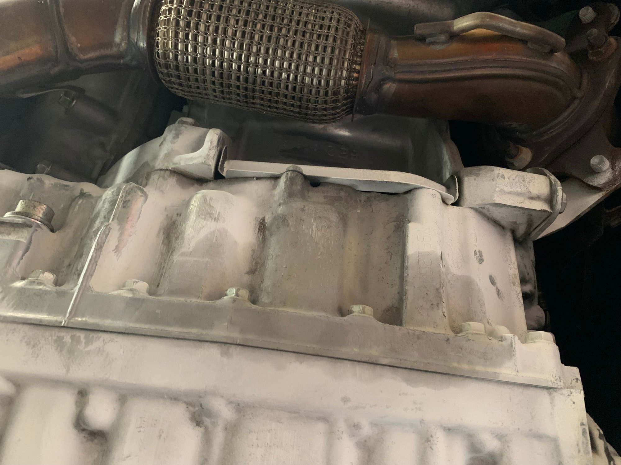

Transmission Leak
Hi fellow RDX owners. This weekend I was performing a what was supposed to be an uneventful oil change… I spotted residue and built up dirt on the transmission case. After taking off the metal piece that covers the transmission housing, I discovered this… please see the below image. Any other DIY’ers that spotted similar situation on their rides or am I an unlucky one with a leaky transmission? I haven’t seen any puddles of fluid in my garage or driveway. What should my course of action be? Take it to the dealer? Wipe it off and watch for re-appearance of fluid? I’ve seen another post here where someone got a new transmission as a result of a leak but I believe the leak was coming from a different spot. I’ve never seen this on any of my cars in over a decade of DIY’ing oil changes, etc.
Attached Thumbnails Transmission Leak-a2f775e2-532b-4a43-b822-5acd67f7795e.jpeg

That doesn't look like much of a leak. If it was me, I would just wipe it off and then see if it comes back.
That’s what I thought on doing, although I was able to wipe off one drip. Might send a video to my dealer and see what they say. Just wanted to see if others have a similar situation with their tranny cases.

Was it red in color when you wipes
it off?

I think it was red at one point, but it’s hard to tell because it’s covered in a bunch of dirt. I was trying to attach a video but need to figure out a different way.
you need to clean it good, let it dry out and keep an eye on it. If its leaking, it will reappear and you can check the color on a white paper towel.

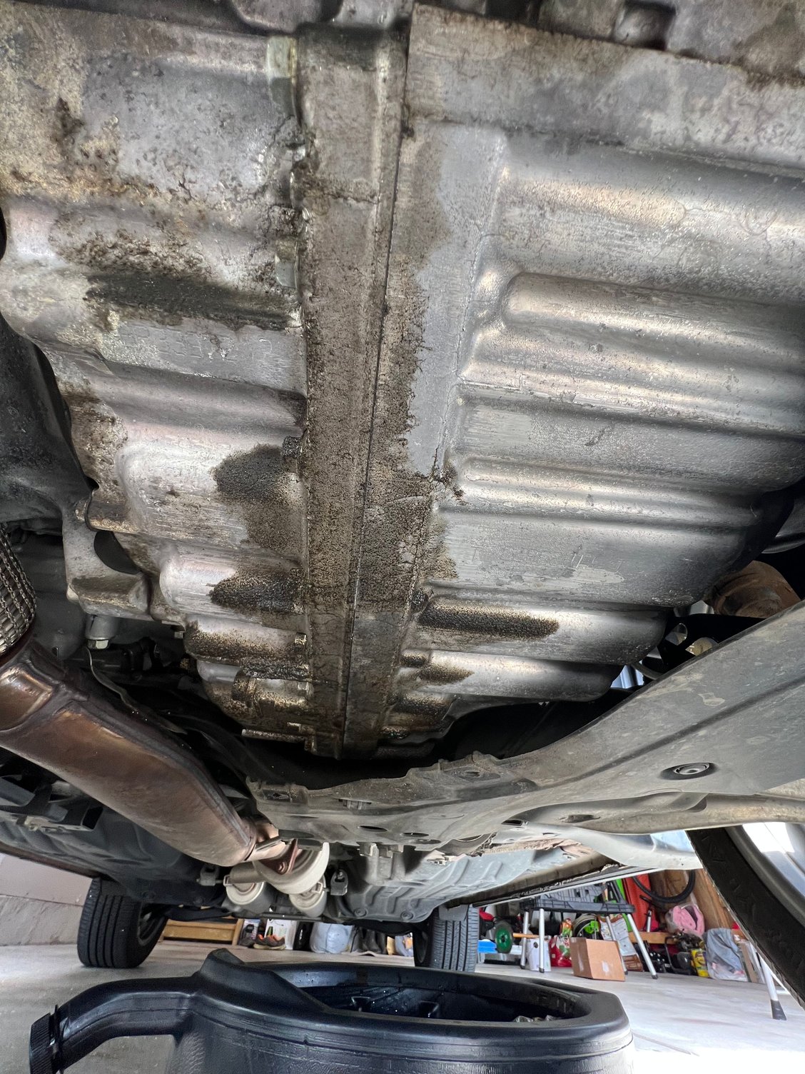

So I wiped mine off clean, and nothing seems to be coming out. However, I think there is a tinny seepage of transmission fluid coming out from one of the bolts. Its extremely small, maybe after 150-200 miles if I wipe paper tower I will see a tinny wet sport that appears to look reddish in color. I first thought its some external water/condensation, so I wiped it clean, and the same thing happened again after few hundred miles. I wonder if the transmission housing bolt is not torqued properly? I am going to have bring it in, and ask them to check torque on all the bolts. its coming from the bolt, but initial mess was definitely from something else that was left at factory.

I have this issue also. There is not much fluid around that seam but there is some on the bolts that is visible. There are no drips on the floor and the plastic cover is dry as well. The fluid in the transmission seems to be the correct level and none is missing but I suspect this will get worse over time.
My guess is that its coming from the bolts and moving down to the seam which is the lowest point. I am wondering if they can be safely tightened or if the gasket is starting to go.
My guess is that it’s coming from the bolts and moving down to the seam which is the lowest point. I am wondering if they can be safely tightened or if the gasket is starting to go.
One of my bolts (as in your picture) continues to release some traces of what appears to be transmission fluid. But the amount is so tinny, maybe in 100 miles a paper towel will show some faint trace of transmission fluid. I did go to dealer with it, and it was useless as they checked torque and said amount of fluid spotting was too small.
it’s definitely coming from the bolt. What are the torque specs for these bolts?

Took another look, yep, some fluid appears to be accumulating at the lowest point of bell-housing (where bolts are). Its hard to see it, but if you touch with your fingers its some oily stuff, does not look red, but could still be tranny fluid that has dried out and lost color. its also not coming from bolts like I thought before, its either leaking from the seal between bell housing or just porous case.
Its small that no drips on the cover plate. Will leave it alone and let it accumulate more and will go to dealer in couple of month the second time. Need to document all this and really push them to get some resolution on this before warranty runs out. They playing dumb and say “its small, and we not sure what it is, looks ok to us and etc”. The only way to fix it might be getting new transmission. I guess acura definition of a leak when you see drips, but thats bullshit, it has to be totally dry. Usually it starts like this, but by the time u hit 100k miles it becomes active leak

update. Some progress, dealer (on my 3rd attempt) acknowledged small leak but claimed its too small. They sprayed something on transmission and told me to come back in 2-3 weeks. I already see stain forming on their spray. The next step if they see the leak, they will call Acura tech-line for advice how to proceed. He did try to say that some small seepage maybe normal, but we all know that no seepage is normal. I think they going to be reluctant to replace transmission for multiple reasons, but I will try.
It looks like the leak is through the aluminum case (porous). The only fix is the transmission replacement….

According to dealership this is not a leak ☹️
yo can see white spray they put is discolored in some
places, yes its not wet, but some little fluid sweating through. I guess not enough for concern?
