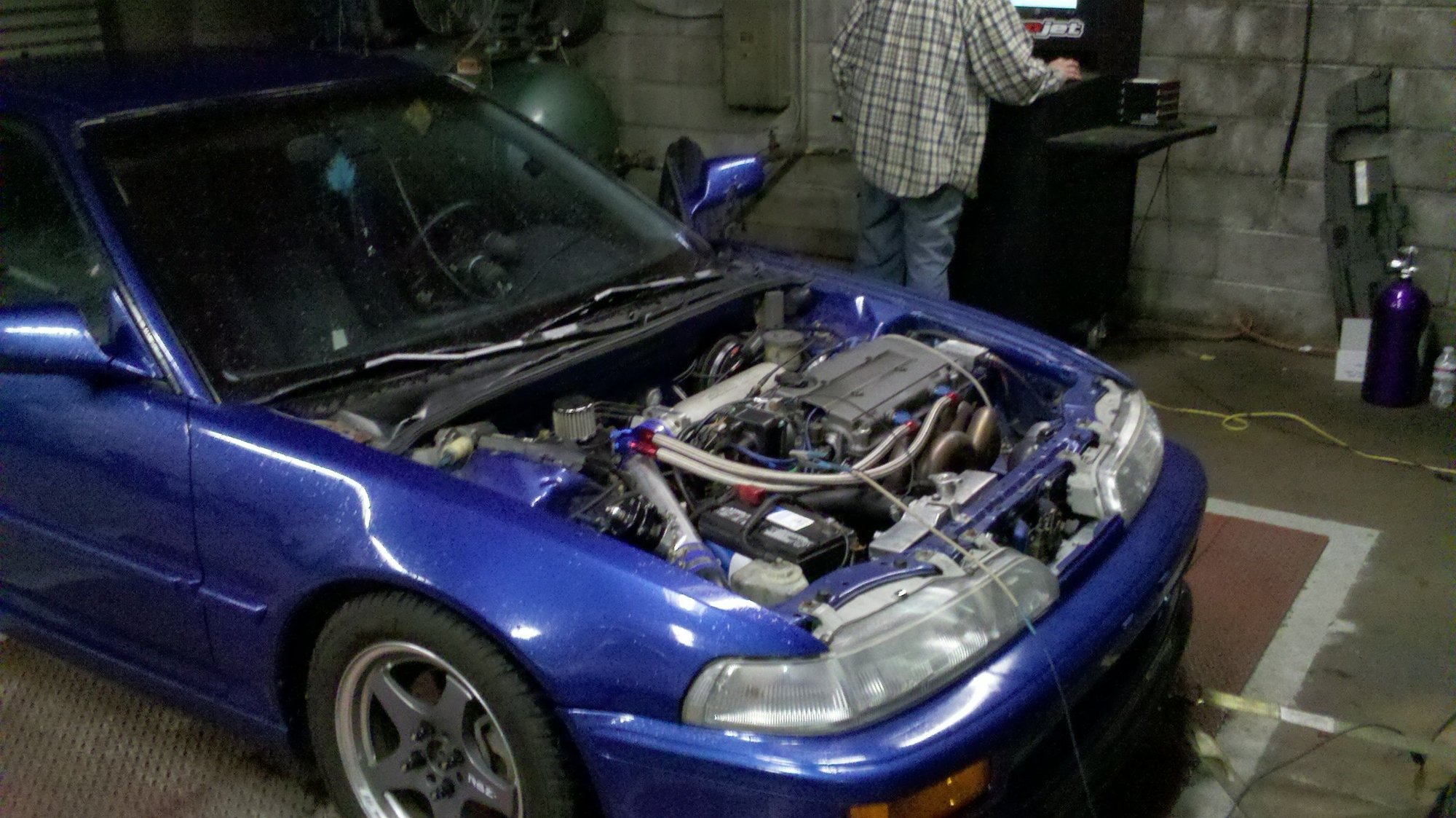

For my Integra I added baffles to the front of the VC and 10AN line to a little custom catch can(this is an old pic but the catch can setup is still the same)
I also have a Focus ST and have an aftermarket PCV plate with baffles and an aftermarket catch can setup, it collects a good amount of blow by, I don't drive that car a ton since I WFH and we take the RDX everywhere but I empty it like every few months and it has about 4-6 oz of fluid at a time in it.
