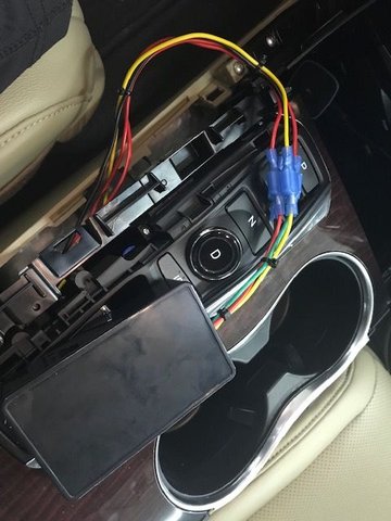

I just got a 2016 TLX and found this very annoying. So I got a delay on and off timer from Deselectra.com for $12.00. I got some black project boxes from Amazon to house it. For the power I tapped into the auxiliary power in the console. Then I just tapped into the wires from the Auto Idle Stop switch, the first two, see pictures. I just used 3M double stick tape to hold the project box inside the console.
So a second after I start the car, the Auto Idle Stop is turned off, a half a second more I can use the switch again to toggle it on and off if I want. So essentially I reversed the way that it works, default being disabled.
I originally used just a delay on relay to short the switch connection, but then it would be off all the time, with no way to activate it. Being anal I wanted it to function, just opposite of the way it came from the factory.

Impressive! So maybe there is hope for the RDX(?) I saw somewhere a claim that on the RDX the switch is connected via a CAN bus and that may complicate the required circuit compared to what is needed for a simple switch (I have no idea whether this claim is correct).
Perhaps some Honda/Acura tech can comment about this.
With the solution described by lieutenantcolumbo, it looks like you end up with a black box sitting somewhere in the console storage (the box looks too large to hide inside the "sealed" part of the console). Now we need someone to miniaturize and commercialize this (like autostopeliminator.com) so more people can benefit from this.

A simple continuity check of the switch should confirm if this method would work for you. Mine was just a momentary contact switch, contacts close when you press the switch and release when you let go. I also used a small wire and to make the connection directly on the connector after I checked what the switch was doing. Short the first two wires and the Auto Idle Stop is disabled. Short it again and it is enabled. All this relay does is mimic the act of pressing the switch. The box measures 3.8 x 2.2 x 0.8 inches(96 x 56 x 21mm), which was bigger than I needed, but I got a five pack for other projects, not just this one. There's probably room for a dozen or two of the boxes in my console, but ymmv.

Two questions:
1) From your description below, it sounds like you could disable auto stop-start by simply jamming the button in the pushed position. Is that right? I have seen reports of that working in some (but not all) other cars.
2) Are you saying that you were able to fit the box and wires inside the part of the center console that is not normally accessible? From the picture I thought you would have to place it in one of the storage compartments and may even have wires visible between the compartment and the inner part of the console.

1) No, simply jamming/shorting the switch will absolutely not work, you need to send a pulse of power after the start up. A pulse of power toggles the Auto Idle Stop off, a second pulse would toggle it on, etc. If there is steady power at start up a the Auto Idle Stop remains on.
2) Yes, the box is placed underneath the gear selection panel, it is hidden away never to be seen again.

[QUOTE=lieutenantcolumbo;16464837]I just got a 2016 TLX and found this very annoying. So I got a delay on and off timer from Deselectra.com for $12.00. I got some black project boxes from Amazon to house it. For the power I tapped into the auxiliary power in the console. Then I just tapped into the wires from the Auto Idle Stop switch, the first two, see pictures. I just used 3M double stick tape to hold the project box inside the console.
I originally used just a delay on relay to short the switch connection, but then it would be off all the time, with no way to activate it. Being anal I wanted it to function, just opposite of the way it came from the factory.]
Here is my question, after you re-enable it and you have a "idle stop" does the accessory power momentarily blip if you have an idle stop and then restart your relay timer? please let me know. Thank you for posting this - I am going to do this this weekend. The idle stop sucks and is dangerous. If you do not realize it is off and try to make a quick left at a stop sign onto a busy rod the start up delay can cause an accident.
Dennis

[QUOTE=Dennis Brenner;16469125]
Dennis
Short answer is No.
The auto idle stop turns off the motor, not the accessory power. That wouldn't be good if your kids DVD player, your radar detector, or your mother's oxygen machine shut down at every red light.
On mine I am also going to insert a switch into the auxiliary power power feed since I already have solderless quick connect terminals there. That way I can turn it off when I take it into the dealer, not that it violates the warranty, just not worth the questions. You can access the switch just by reaching your finger between carpet where the bottom of the console meets the transmission hump. I'll post a picture when I get around to it this weekend.

Since I already had quick disconnects I inserted a switch. Now if I want I can disable the relay (when I take it to the dealer) and keep the switch tucked into the console cover.

So has anyone actually done this on a new RDX yet?
If so, how did you go about getting to the switch wiring? I wouldn't mind adding a relay if you don't have to tear the interior apart just to get to the wires.
