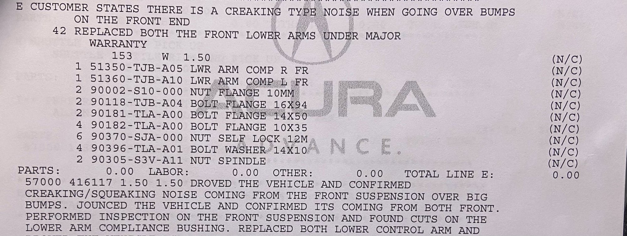

Hello everyone! I finally got around to getting my RDX serviced for the clunky sound. It was straightforward as I referred the TSB to the service advisor, and they knew exactly what I was referring to (they mentioned it was a common service done to 2019-2020 RDXs).
The dealer had to make an exception for the service and cover the service under the 'Major Components - 5 years / 100,000km' warranty as my 'Distributor's Warranty - 4 years / 80,000km' had expired. I also had to pay for an alignment after replacing the lower control arms.
Overall, smooth and quick process. I recommend anyone with a 2019/2020 RDX to have the lower control arms serviced before their warranty expires, or else it's a costly job (they estimated over C$1200).
Below is the parts list in case anyone needs it.
Thanks again for the helpful advice!
