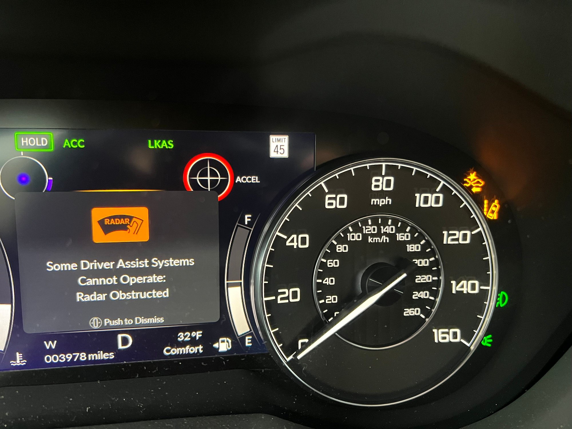

Was driving yesterday and it was lightly snowing, a slushy kind of snow. Nothing was accruing on the ground, but it was building up a little on the car. And i got this message (see images). So i pulled over and wiped off the sensor under the logo and then the 2 by the fog lights. Error was still there. So i drove home. After about 10 minutes driving, the error went away. I couldn’t use the ACC. Is this something i am going to have to deal with all winter during the snow?

Yep your stuck with it. Wet snow will constantly build up on the sensor and cause this. Nothing is wrong any of the systems.

Normal and actually good that it occurs. IMO
most people complain about the errors but in hazardous or extreme weather you want all driving aids to be off and to have full control.

I found if I remove the snow on the the Acura emblem by the grill ,turn the car off and restarted it , it would now work fine but if more snow builds up it could reoccur again

Yep, it's a common occurrence any time there's snow/wintry mix. Cruise control during snow is a no-no anywho.

Many times this happens the road is nothing more than wet as the snow melts as fast as it comes down, usually very wet snow with the temperatures just around the freezing point.
