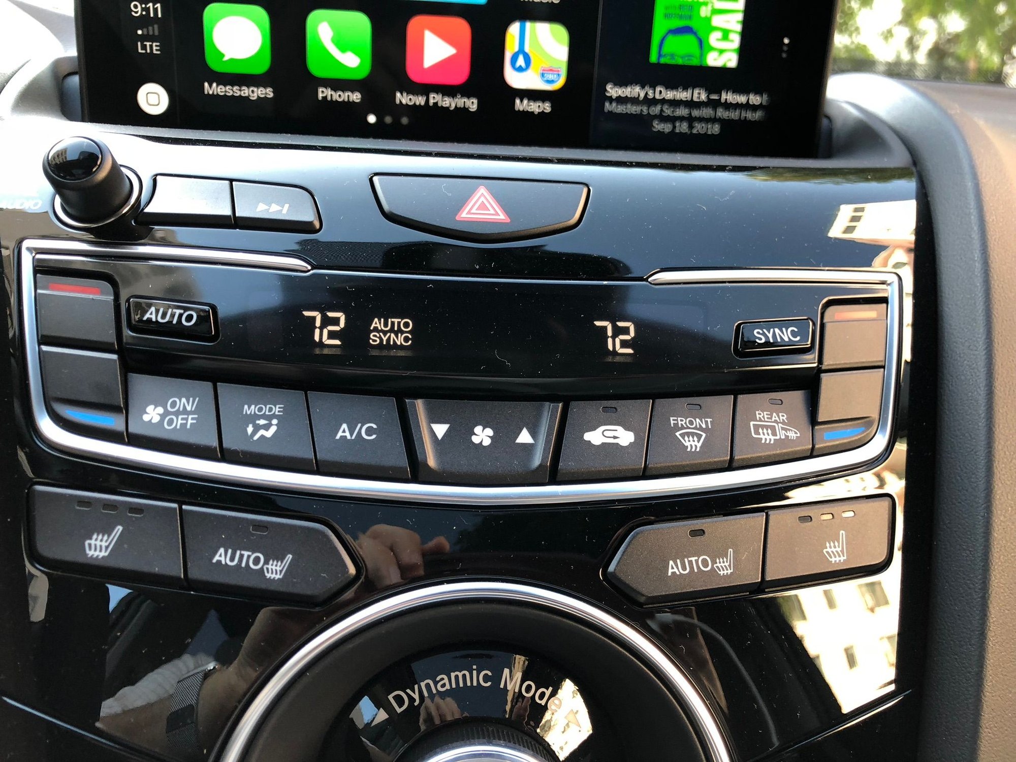

It feels like this has been settled, but I had my AC set to auto yesterday. It cooled the cabin. When the temperature reached the deisred point, the Circulation light did turn off.
Old Sep 21, 2018 | 04:21 PM
  #43
Cazman's Avatar
Joined: Aug 2018
Posts: 165
Likes: 27
Thank you for the pic. Yours is working properly so there is hope that many of us will get a fix in a system upgrade. May I ask when you took delivery of your RDX and what model it is (base, tech or advance)?

Tech, picked it up at the dealer on Sept 8.
