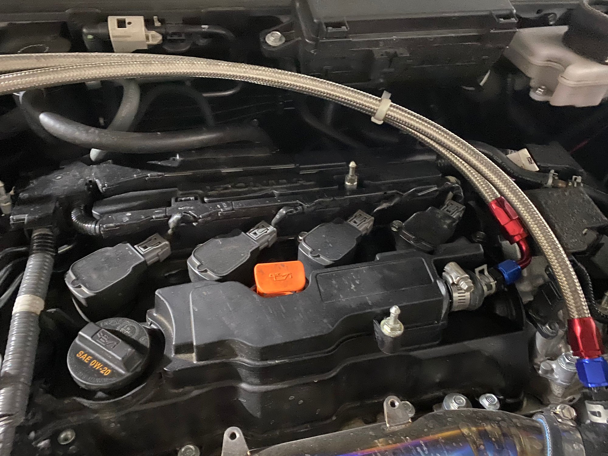

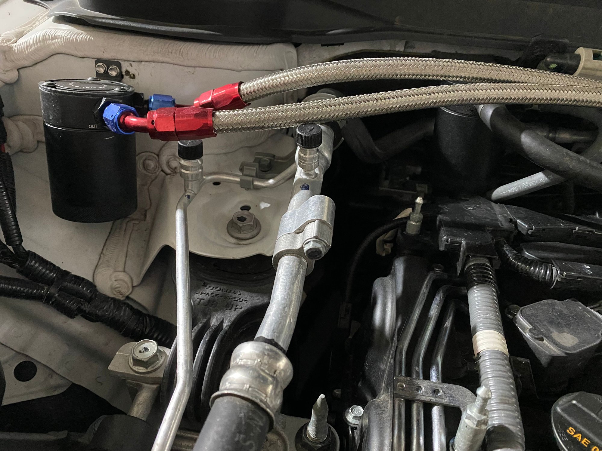

Old Feb 9, 2022 | 05:06 PM
Rob5150's Avatar
Joined: Apr 2020
Posts: 208
Likes: 87

Originally Posted by Rob5150
looks like mishimoto catch can? If not what brand is it ?
both cans are mishimoto

Can you please explain the “inlet tube” side part of this? I figured there was just 1 hose running from the crankcase to in the intake.
I like your install, very clean. Where did you get the braided lines and metric fittings?
Lastly, do you know what size the crankcase vent diameter is for proper hose size?

Inlet is the intake tube before the turbo-it’s under constant vacuum and always draws crankcase vapors into the turbo-oil on compressors wheel is not good- neither is it good in the intercooler and tubing etc-
do a quick inspection of the air inlet tube inside and you’ll see!
I had some a/ n fittings and braided hose from other projects that I used
