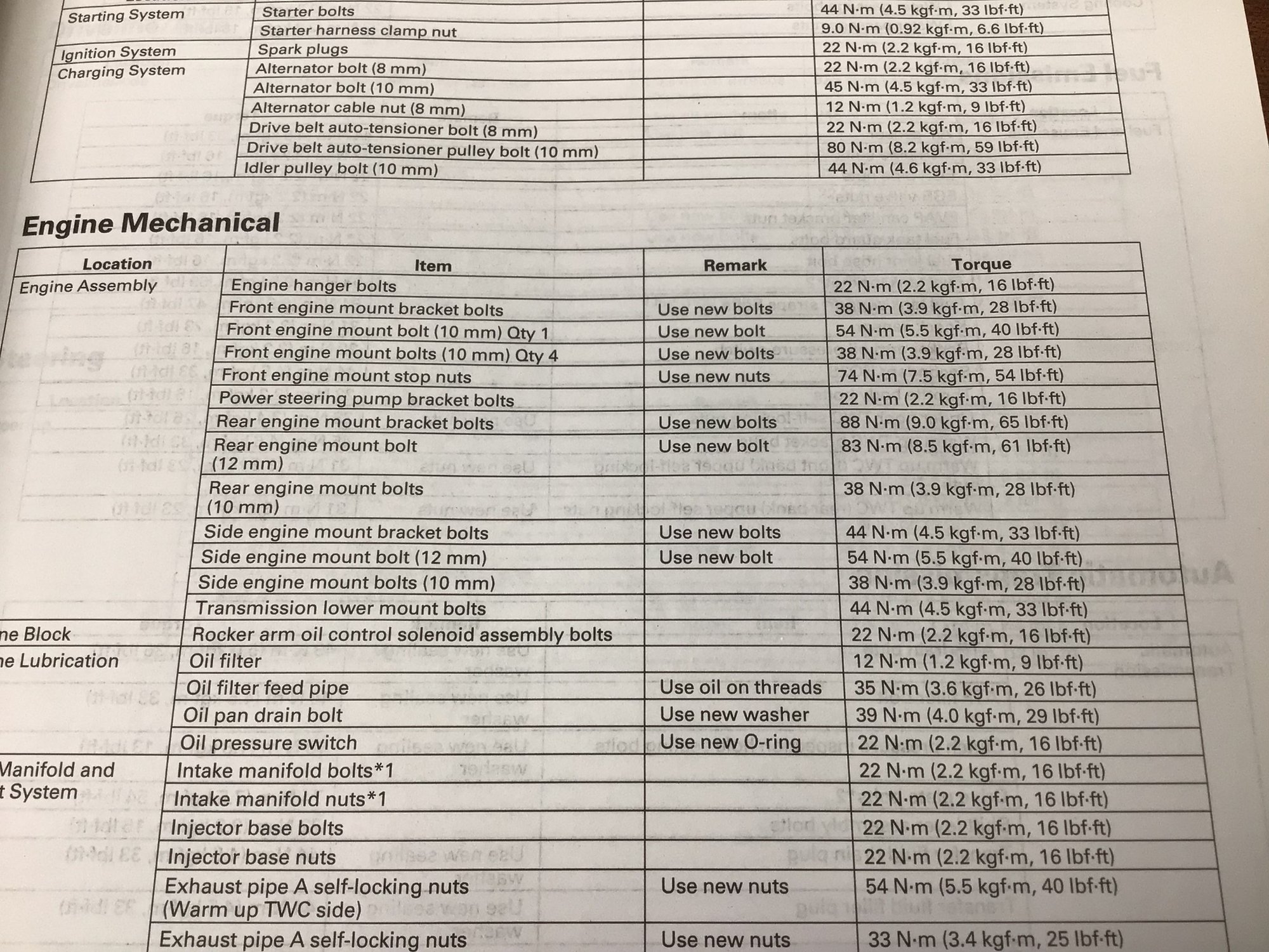

Thanks so much for replying. I am mainly searching for the torque values of the various bolts. On the back of the pan, there are 4 17mm bolts. Would you happen to know what the torque spec on these are?

Ok….miss read the need
17mm socket size are almost always 12mm diameter bolts.
14mm socket size are almost always 10mm diameter bolts
12 mm socket size are almost always 8mm bolts
This is picture from a HONDA manual ( NOT RDX) that gives normal torque for various bolts in various location.

Old Jun 19, 2022 | 06:08 PM
Tachyon_flux's Avatar
Joined: Jun 2020
Posts: 67
Likes: 19
Originally Posted by Showkey
17 mm socket size are almost always 12mm diameter bolts.
This is picture form HONDA a manual ( NOT RDX) that gives normal torque for various bolts in various location.
Yes, I believe you are right about it being 12mm. Thanks for your help!
Also, I have since learned that these 4 bolts are to secure the bracket for the lower torque rod mount. Do you think the torque values would be similar to other engine mount brackets?

Don’t over think this……….it was loosened by mistake, use the same effort to retighten as you used to loosen it.
8-12” long ratchet ……tighten and your done.
Tighten enough and good-N-tight might apply here.
