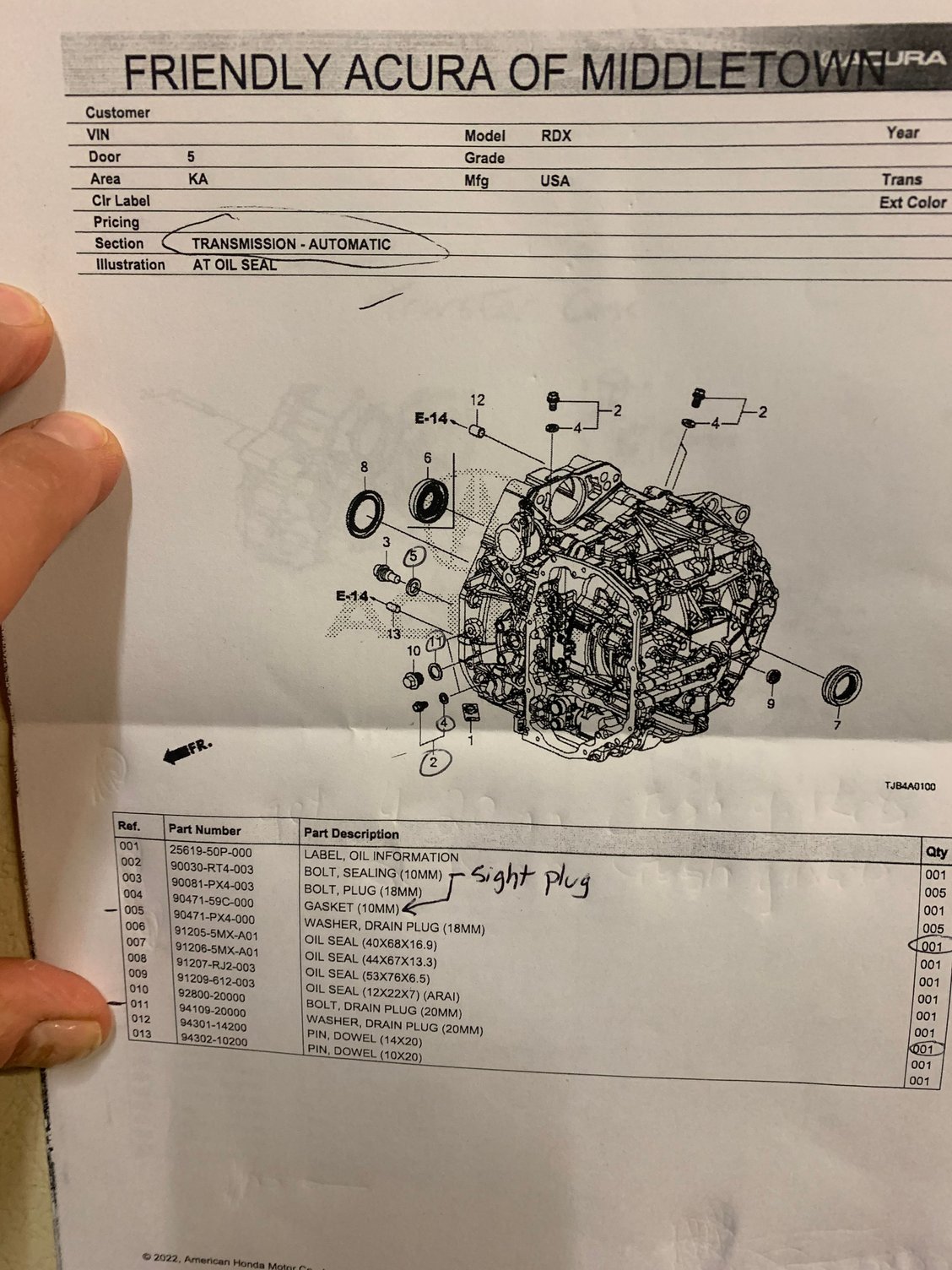

Regarding the sight (level) plug -- was it a bolt and separate washer, or a bolt with a captured washer? If separate washer, do you know the size? Thanks.

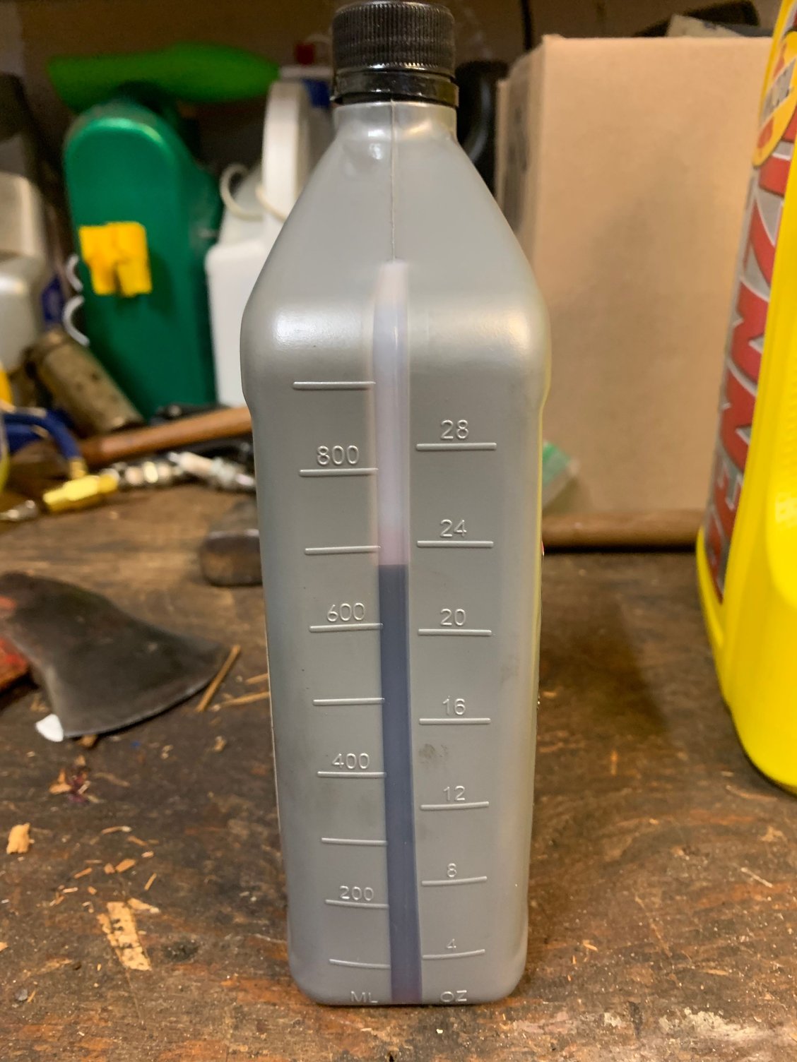

After reading your post I picked up another quart of the ATF 2.0 and 20mm crush gasket. I got the RDX to full operating temps, ran it though ALL the gears multiple times and then drove the front end onto ramps and jacked the rear until the car was level. I pulled the sight plug and nothing came out. I pumped in approximately 8 ounces (I will try to post a picture of the side of the bottle) when fluid began to come out of the sight hole. I installed the plug and button it all up.
The sight plug did not have a crush gasket, however the IPB shows a gasket and its part number is 90471-59C-000. Next time I do this job I will get the crush gasket. When I was at the Acura dealer this morning they did not have that gasket available.
