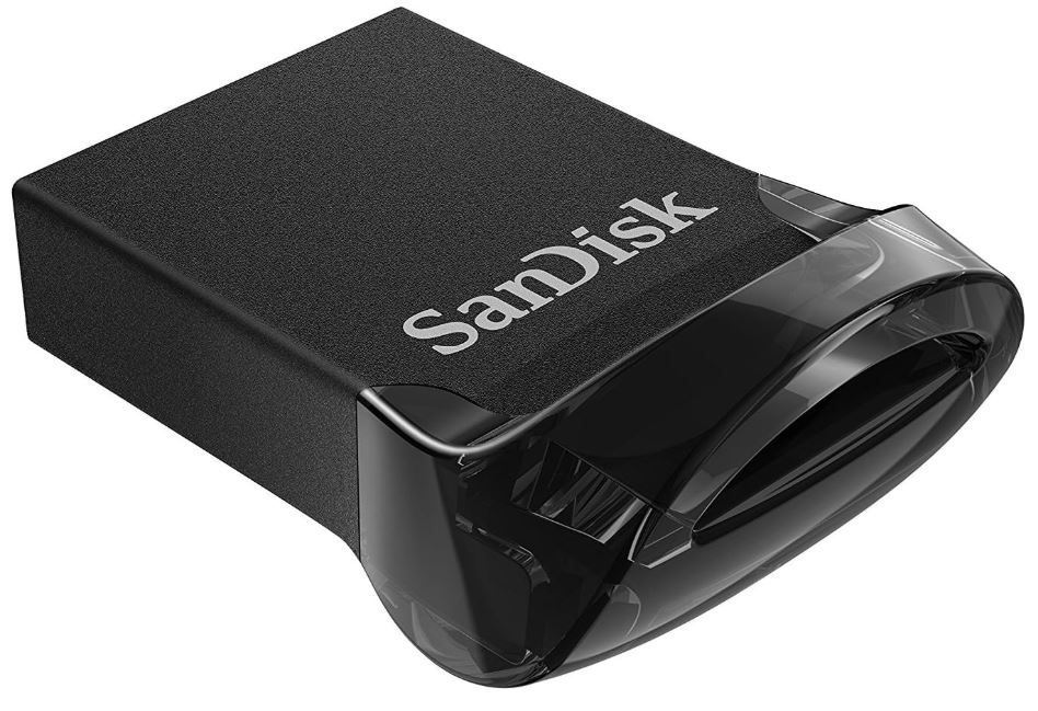

Unless you've done something special, a 256GB drive would not be formatted as FAT32. It would normally be formatted as exFAT. exFAT is what I run on a 2022 and I do so without any issues. I use a Sandisk UltraFit, about the size of a peanut.

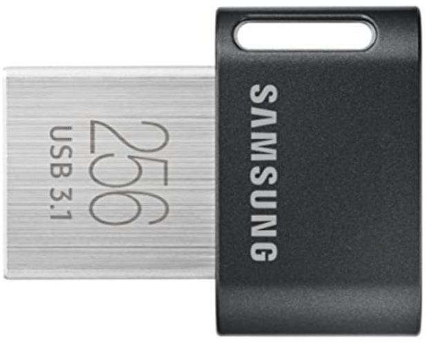

Good call - I always forget about the size limit for FAT32. It is indeed exFAT, and mine is a Samsung about the same physical size as yours.

So, coming back to this, I tried a handful of other thumb drives and found one from Sandisk that hasn't skipped in the 6+ months I've been using it. It does ultimately seem to come down to the drive itself, and I guess Samsung isn't the gold standard it once used to be. Since the Acura link app has also been hot garbage for months now, and with the recent update to allow Android Auto to use the full screen, I've primarily been using AA and playing the music off my phone since you can't use a USB drive at the same time as AA (seriously though - why?). So yeah, either way there's a compromise to be had.
