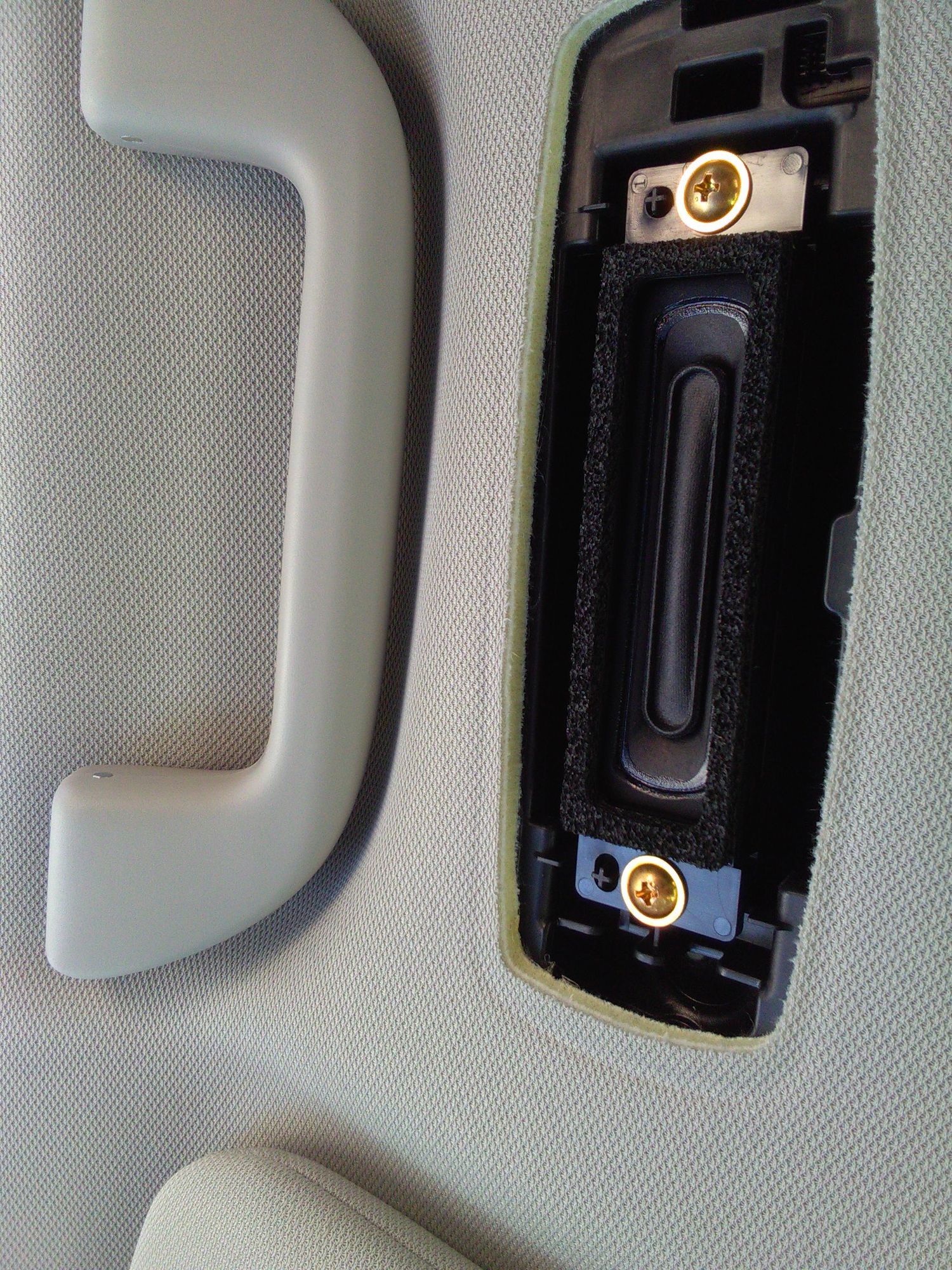

I'm sorry, I don't know what multichannel FLAC files are. And I suspect those speaker grills on the roof are a universal grills for all RDXs including the A-Spec that have drivers in there. Is a simple test just to remove the grill and see what's in there? Don't they just pop of?

Well, this explains a lot ... So, there is a little speaker up there, it does make a very slight difference when I turn up the roof speaker setting, and the center speaker setting also changes the sound when I squeeze my big head between the windshield and hot dashboard.

That 4 little speakers here raises or spreads the sound stage up a bit, hence 3d, like a few other car manufacturers do. There does not need much power since it's so close to your head.
