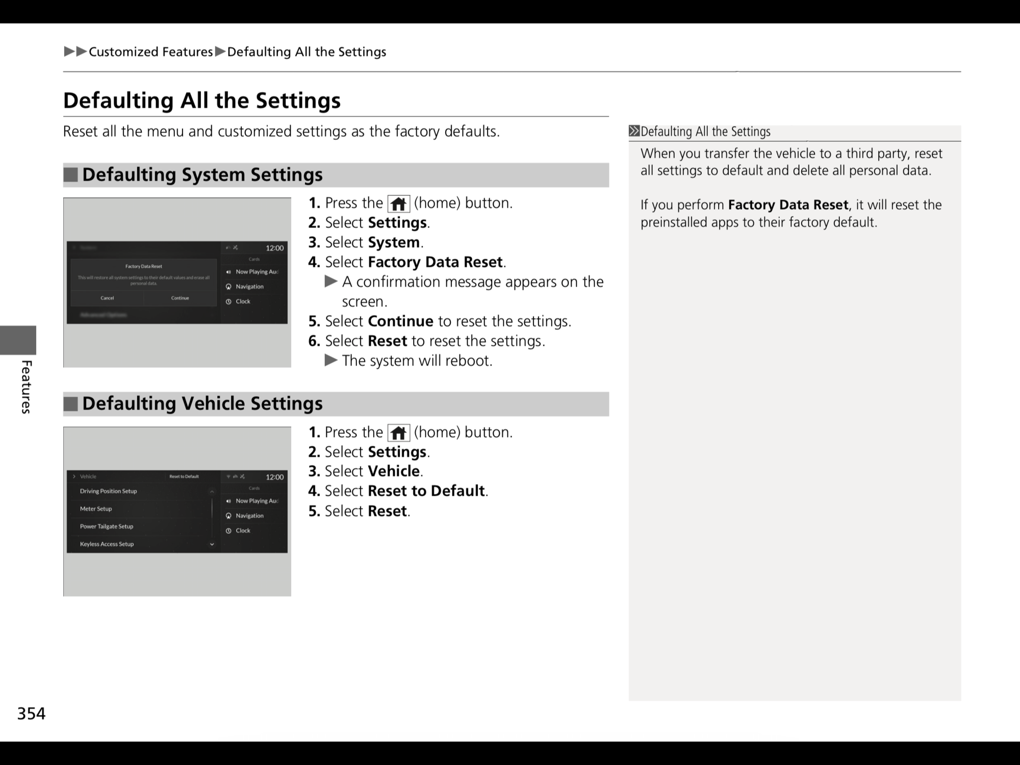

Do a system reset to defaults, not a three button one. That might help. You will lose your settings.

Try 3 button reset couple times and it's not working. Reset to factory and it's not working. Bring it to dealer this moring though COVID-19 is getting horible in bay area. Dealer fix it within an hour, and told me it's system glitch... They do not reset the system and my favorites are still there. The memory setting of the seat seems off and not jump back to the position I set.. Let me try some more time with this. Still love the car, and it's the first time I bring the car to dealer with infotainment issues. The fix is free and get free car wash. The cost is about an hour waiting. Not to bad.
