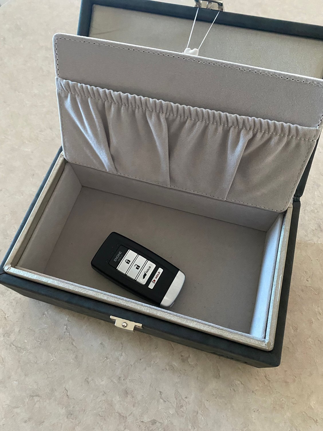

Thanks for the info Rick. I've used fresh Duracell 2032 cell with 10 years expiration dates. I am keeping Remote No 1 in the cage and No 2 outside of it and will compare how both remote batteries last. Will update the thread in a few weeks time or earlier if No1 remote battery dies prematurely again. Attached is the faraday box I am using.

Looks like a coffin for it

Is that box 100% all metal; sides, top and bottom? Otherwise it isn't a Faraday cage. Easy way to check, as someone suggested earlier, is carry the box with fob in it to the locked car and see if the car unlocks using the buttons on the handle.

Yes it is John, tested by the car and totally shields the key fobs signals.
