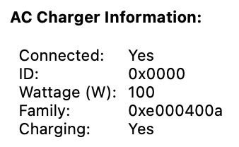

Well, just one brief car ride with the UGREEN 150W USB C Car Charger, PD 3.1 140W Car Charger and it is working great! Lesson learned: skip the AC inverter for a laptop... USB-C ftw!
UGREEN 150W USB C Car Charger, PD 3.1 140W Car Charger at work on 2021 MacBook Pro
