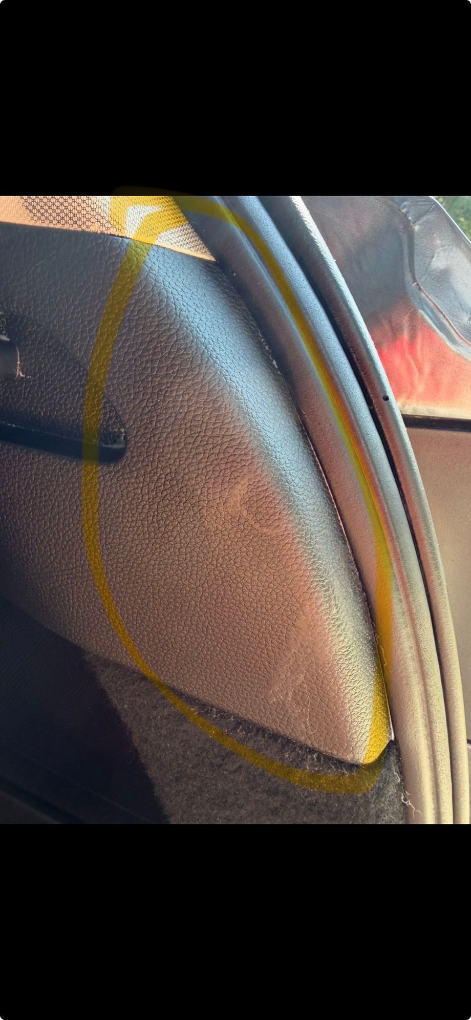

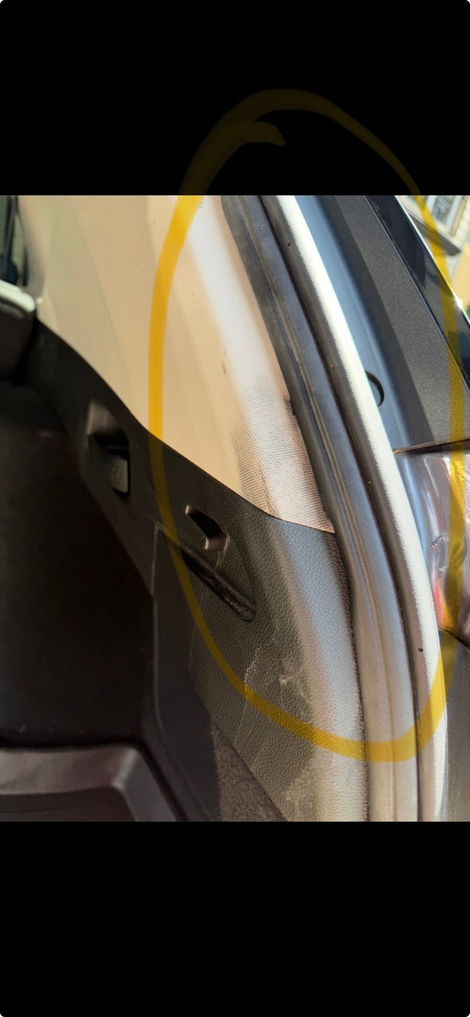

Hello everyone,
I hope you’re all doing well. I wanted to post an update on this thread with some good news and some bad news.
Good news: I checked in with my service advisor and explained the symptoms I was having. I also brought a printed copy of the TSB with me, and he knew exactly what I was talking about. My VIN was included, there was no diagnostic fee, and everything was covered. So far, the crackling/popping noise has not returned. It took me roughly 40 minutes to drive home from the Acura dealership, and I did not hear the noise once. Hopefully, it stays that way and does not come back.
Bad news: I dropped my car off early in the morning to have the work done. Later, when I called to check the status, I was told the vehicle was ready for pickup. When I arrived at the dealership, I met with the same service advisor. He handed me my key and told me the TSB covered everything and that I should be good to go. Before leaving, I did a visual inspection of the car, and I was not happy with the condition of the rear area, especially around the rear right side of the vehicle. There was a large black spot/stain left on one of the rear interior trim pieces. I went back inside and spoke with the same service advisor. He came back out with me to view the black spot I was referring to, and he was kind enough, respectful, and tried to clean the area with a rag. He did his best, but the dark black spot seems to be stuck on the trim and is now difficult to remove.
Another thing I noticed was that the rear trunk seal area, which I highlighted in yellow in the photo, was hanging loose and wasn’t secured in place. I’m not sure why that area was touched during the repair. There was also some type of black glue or adhesive stuck around it. When I opened the trunk, that piece was loose, so the service advisor pushed the rear trunk seal back into place. Since then, it has not come loose again. At first, I was a little worried about water possibly getting into the car, but since the seal is now back in place and feels secure, I’m not as concerned about that anymore. What bothers me more is the sticky residue left behind, along with the black stain on the rear interior trim.
What I found interesting is that the service advisor said there should not be any glue or black adhesive near the rear trunk seal, so I’m not really sure how it ended up there. Has anyone else dealt with something similar after having the FAKRA connectors replaced? I’m glad the crackling noise seems to be fixed, but I’m not happy with how my car was left after the repair. I wish I had taken some before photos of the interior and exterior when dropping my car for service, and then had the proof to compare both photos to show my car was not dropped off like this, and something happened while working on my car. Something isn't adding up to me, but I'm not sure what can be done now.
Does anyone have suggestions on what I should do next? I’m mainly looking for advice on whether there are any safe products or cleaning methods to remove the sticky residue and black grime without damaging the trim. Haven’t had much luck using the Meguires stuff I have.
Any feedback would be greatly appreciated.
Best,
DONSRK

I wanted to bump this thread and see if anyone has any additional recommendations for post 13?

*always test in an inconspicuous area if possible*
That said, you might try Goo Gone or similar on the plastic trim part. For the fabric, maybe rubbing alcohol or hand sanitizer? Dish soap or vinegar may also be effective, and perhaps less risky than rubbing alcohol.

Soapy warm water mixture and a micro fiber towel. May have to go over it a few times, then maybe an interior trim cleaner. Surprised Acura returned your vehicle that way.
Mine just has some silicon spray where they fitted the external sunroof seal for the sunroof frame into the roof opening on the outside. They tried to clean most of it off, but I got the rest off.

Ah okay. Thank you for the soapy water recommendation. I'm planning to do a car wash this week. I'm still a bit disappointed in the way my car was returned, but hopefully, through some interior cleaning products. The black spot and sticky residue go away.
