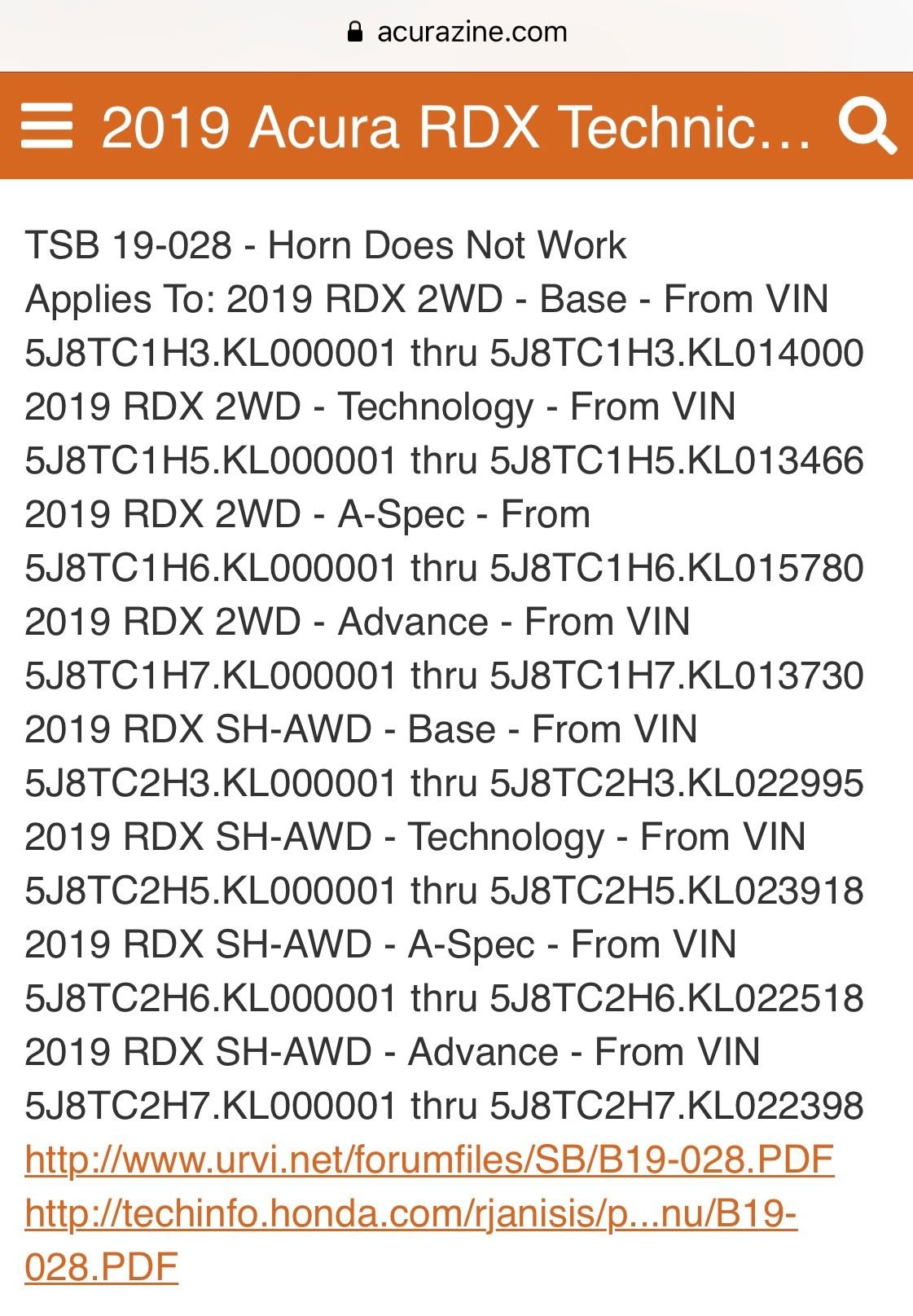

Well today my horn no longer works. I will have a nice list when I get it into the shop

There is a TSB for that

Old Aug 19, 2019 | 12:32 PM
Dereileak's Avatar
Joined: Oct 2018
Posts: 1,062
Likes: 333
From: Minnesota
Old Aug 19, 2019 | 01:33 PM
ray1968's Avatar
Joined: Aug 2019
Posts: 14
My vin is listed
