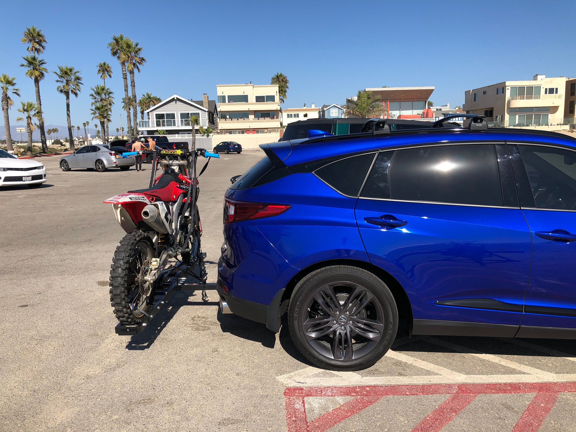

This is mine, it’s the e-trailer drawtite class 3. I’m super happy with it. It doesn’t stick out too much imo.

Cool - and useful! Looks like it sticks out about 3-4 inches. Sound about right?

Yea give or take. It doesn’t bother me at all with the hitch sticking out. It actually makes it more utility like ; )
