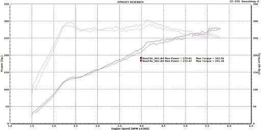

Unfortunately, with a rolling start it's still slower. It's likely that the engine is capable of producing all the advertised torque, but it's being held back at lower gears to protect the drivetrain (btw this has also reportedly been confirmed by Acura engineers). Unlike most other turbo competitors where the peak torque is actually achieved over a pretty broad range of the revband, you can see from the Hondata dyno that the torque curve is quite peaky. Practically speaking it's putting down less power than you would expect.
What about 280lb-ft torque, I will take higher torque over tinny difference in 0-60
See the above dyno. You're not actually getting 280lb-ft of torque through much of the powerband.
how does this graph compare with 2nd gen RDX?
I don't know if anyone bothered to put a 2G RDX on a dyno, but in every other application of the same J35 engine, the dyno looks exactly how you would expect a normally aspirated V6 dyno to look. No surprises, and it performs how you would expect it to perform based on the advertised numbers. In comparison, the 3G RDX dyno looks unlike what you would expect a modern 4cyl turbo dyno to look, and as such the real world performance doesn't live up to the advertised numbers. You'd expect it to have a nice fat and flat torque curve like you see here on the same K20C engine in an Accord 2.0T. See the difference there?

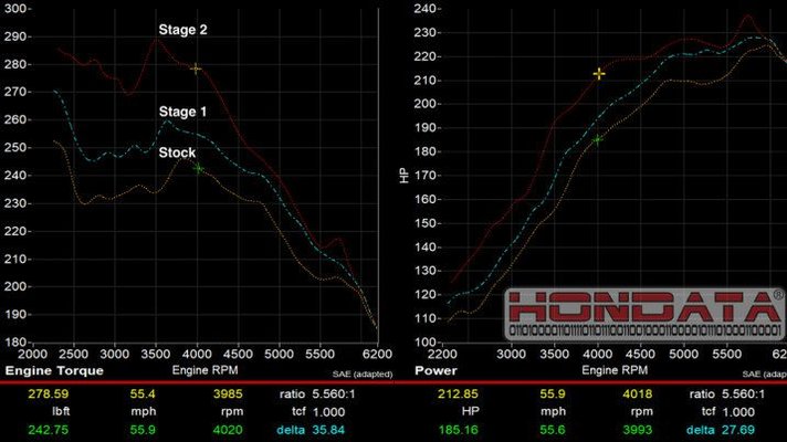

Need to see the same graph from Hondata/ktuner, otherwise its apples and oranges. Turbo has higher torque at lower rpms, this aspect of turbo is what I like.
You can’t compare numbers between dynos, but you can certainly compare the shape of the curve. Regardless, the Hondata graph very clearly illustrates that the torque curve for the RDX is non-ideal. Unless you are blind you should be able to clearly see that it is not making more torque at lower RPMs; there’s very clearly a big drop off, so even if it’s making 280lb-ft at 1800rpms as claimed, it definitely is not maintaining that from 2500rpms onward.

That’s how 4 cylinder turbo normally work, choppy power. So what? It has initial big kick, and then it’s choppy.
Most modern 4-cylinder turbo engines make a very flat torque curve, with peak torque at very low rpm (around 1200 to 1500) and staying flat until around 5000 rpm. That's what gives these small turbo engines such amazing torque from a dead stop.
Uh that’s not how they work. Where did you get that idea from? How many 4 cylinder turbos have you even owned or driven?
Exactly, and as we can see from the dyno charts that isn’t what this engine does. Not sure why russiandude can’t seem to get that through his head.

The curves show that HP ramps up quick at lower rpms and than flatness out. V6 power is more linear from the start, as to why some think v6 is more smooth. Torque also pretty high up to 4000 RPM (250 LB-FT from Hondata). Power is important to me at lower RPM range.
No data was provided for 2nd gen RDX power at the same range, likely its smaller given its not turbo.

The curves show that torque ramps up quick at lower rpms and than flatness out. V6 power is more linear from the start, as to why some think v6 is more smooth.
Please point to where it "ramps up quick at lower rpms". All I see is a huge drop starting at 2000 RPMS that stays flat until 4000RPMs, and then a sharp increase.
I said HP ramps up quick, and starts with high torque.
