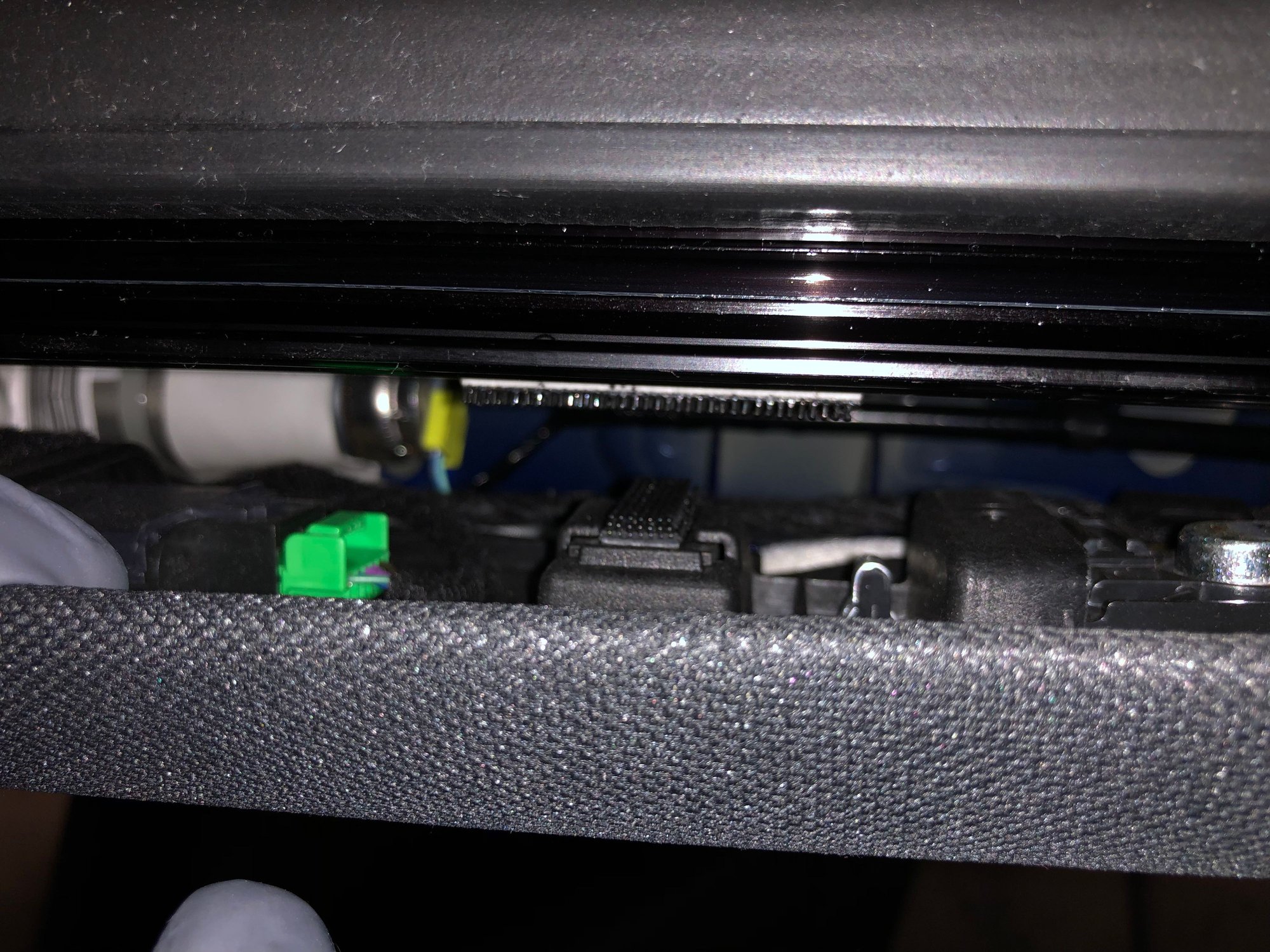

The headliner uses almost like a Velcro but a stronger version to hold it up. Go around and push hard on the headliner to reattach any pieces that may of come loose
To me it looks like the part that is on the headliner is turned the wrong direction to get optimal connection, whoever built these at the factory must of been having an off day
