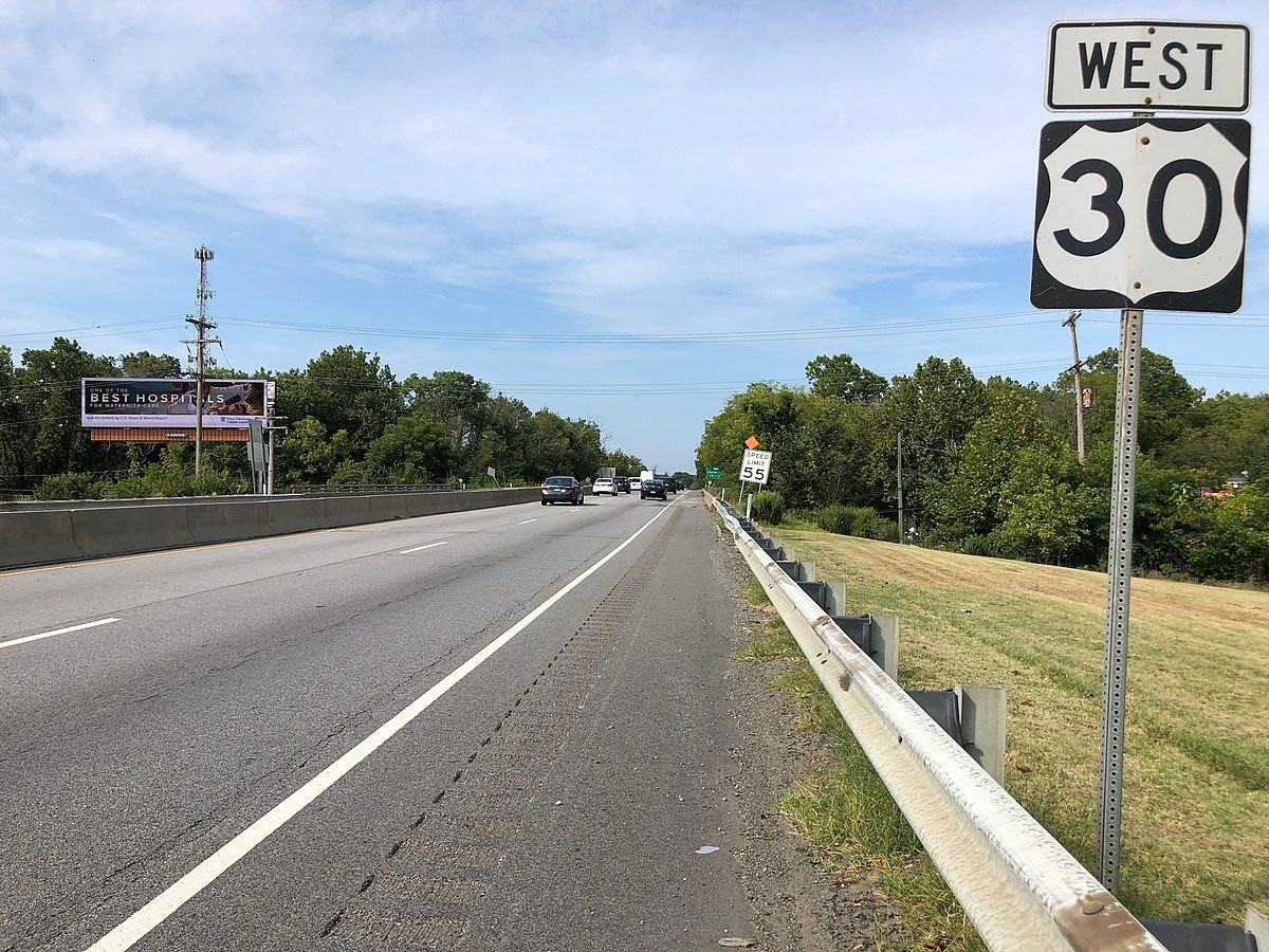

Since posting my previous comment I have been observing when my dash speed indicator indicates "100 mph". The algorithm that determines what gets posted on the dash seems to be definitely confused by some highway signs; see one immediately below that is for PA Route 100. That particular sign consistently causes the vehicle to display "100 mph" and within a split second of passing the sign.. It also occurs on numerous other Route 100 markers in my travels.
Again, no navigation on my 2022 RDX but I also noticed today in my travels that as I pass a PA Route 30 sign, the dash display says 30 mph, even though I'm in a 45 mph zone. And just down the road is a 55 mph sign and that bumps the dash display to 55 mph (as it should).
