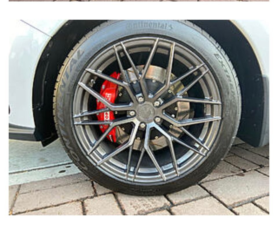

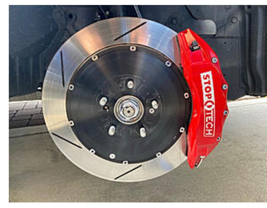

Originally Posted by gordonary
Tirerack has a number of different brake pad options from brands like Hawk and Stoptech. I had Stoptech's on my old Civic Si, has anyone tried any of these on their RDX?
These pics came from somewhere on this forum - I think they’re on 2019-20 RDX
