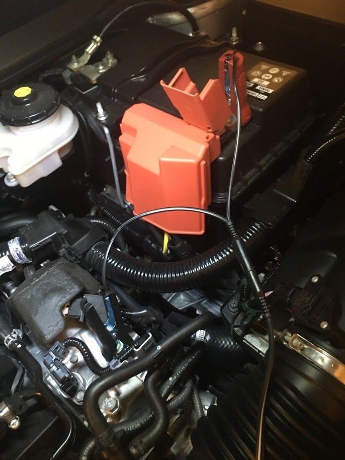

Battery tender connection
Hey everyone... I read through the posts in this thread and didn’t find this information, so I’ll ask ... Regarding the connection of the battery tender itself or any of you using the smart battery charger with the cigarette lighter connection? Or are you all using clamps connecting to the posts under the hood? I have a smart tender I have for my Porsche - it is a CTEK with AGM mode. It connects via the cigarette lighter socket - can this be used with RDX?

Connect like in this picture. This is also what owner manual states when you get a jump start.
Following the manual recommendation is the best answer.
I use a maintainer regularly for another car and used to use the alligator clips. I'd make the battery connections first and then power on, to avoid any sparking. I later added permanent leads to the battery (similar to picture below) and now just plug in when needed. I was able to find a hidden spot inside the grille on that car and I can connect without opening the hood. I don't think the RDX has a similar hidey-hole that would permit this remote connection, but it's still possible inside the engine compartment. You'd have to be comfortable with working on battery connections, however. This is NOT a carefree procedure if you don't understand what's involved. This is just an option if you are technically savvy.
As for the cigarette lighter connection... I can't give a good reason, but I've never been comfortable with that charging method. It's commonly done, but I just don't like sending current from a third party device through the internal network. YMMV.

did you connect both of them to battery terminals, or only red one to battery and black one to the body of the car?
<disclaimer> Not an expert, but did a lot of reading recently <disclaimer>
For the battery tender scenario, it doesn't matter. The reason why the manual recommend connecting the 4th connection (ie. negative lead to the ground/chassis) is to reduce the chance of the spark igniting the hydrogen gas from the battery causing an explosion. Apparently, car battery can emit hydrogen gas. Since the 4th connection (when you complete the circuit between the two battery) usually generate a spark, so it is recommended that you make the 4th connection to the chassis and far away from the battery terminal, so even if the battery does emit hydrogen gas, it would ignite the gas.
However, for the battery tender scenario, the final connection should be made at the SAE connector (the black plug at the other end of the red/black leads). The SAE connector shouldn't cause any spark due to the spark free technology that all battery tender features. Even if it does spark, it should be far away from the terminals, that it wouldn't ignite the gas.
