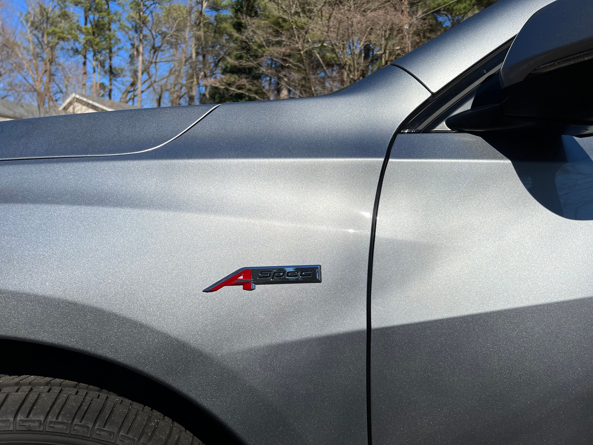

I feel left out of the "Premium Paint" party since I have Lunar Silver — and that's not mentioned among the premium paints. (It sure looks premium to me, though.)
Best-looking silver I've seen.
