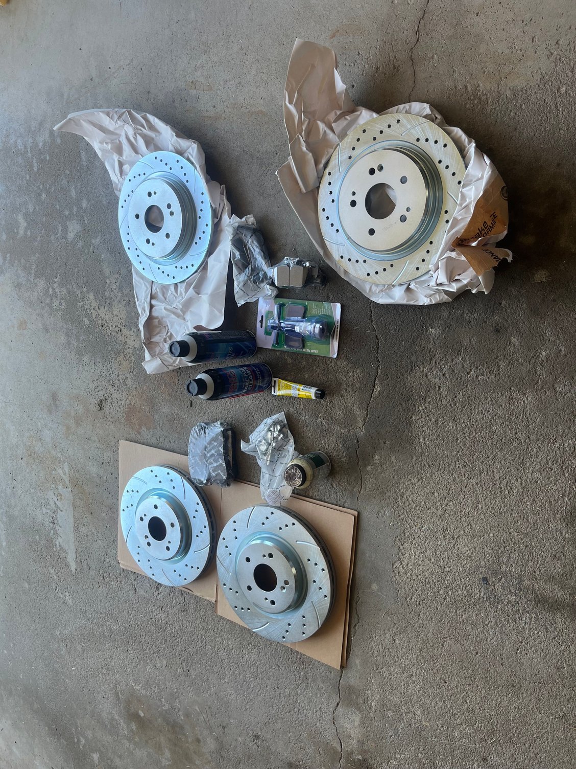

After 6-years and 100k, the original, faded and slightly warped rotors and pads needed to go. It being my first time changing them, wow, were there lessons learned and harder to swap than on other cars, but well worth it!
I found slotted/drilled rotors (only because I personally like the way they look), and went with standard pads, versus ceramic. Hoping they aren't terribly dusty!
Started with the back brakes and needed to remove the electronic parking brake...then needed to run and get the H-7 socket to remove the rear caliper bolts. The screws holding the rotors to the wheels were completely corroded - heat and hammering loose did not work. Ended up needing to drill out all 4 set screws. Ugh. Did not replace those...I need a compelling reason to add them back on.

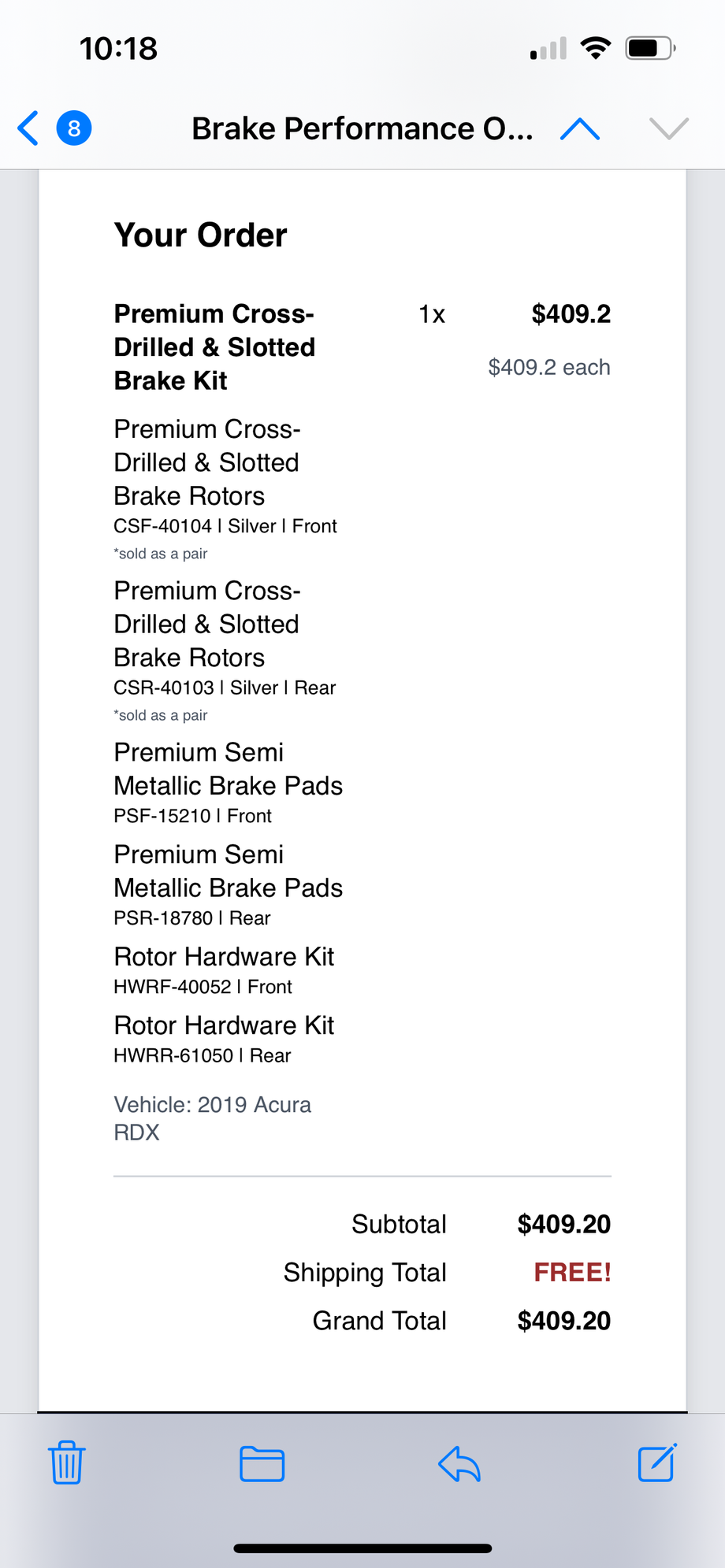

Front pads and rotors weren't too much trouble and took me no time. Overall happy with the greatly improved braking and the look. Bought the set of pads and rotors from Brake Performance which included the zinc coating and only $409 with free shipping. Seems almost too good to be true. We'll see if they hold up or are junk after 20k miles...
