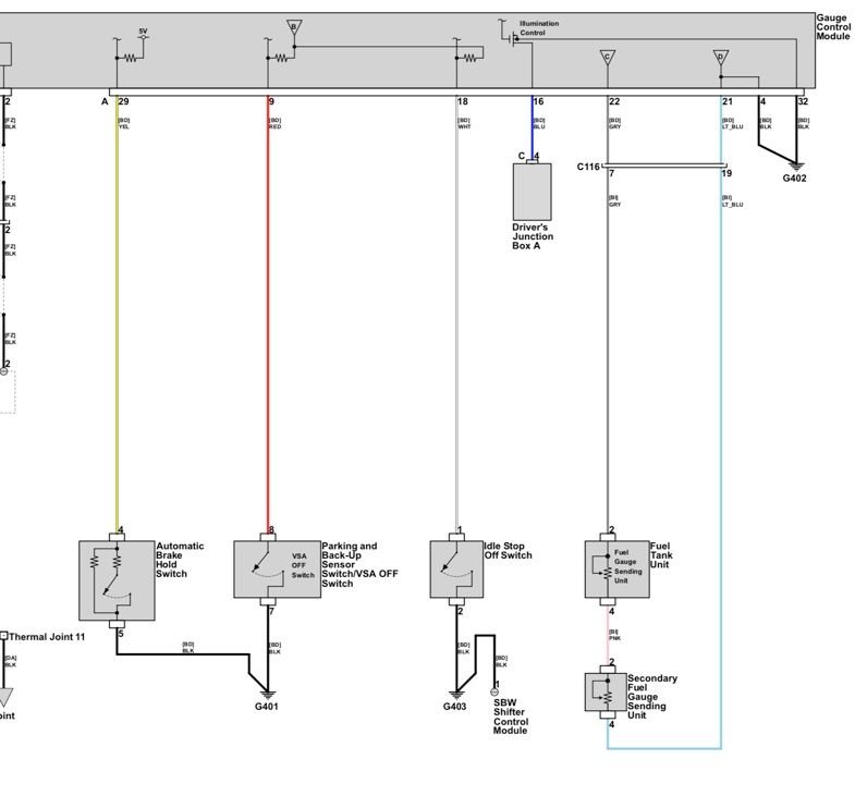

Hm, very cool. But, does anyone have a write up of how to remove the center dash to get behind there where the Stop/Start button is?
yes.
But looking at it, as soon as you remove the gauges, you have access to the idle line, since it goes from the switch to the gauge cluster. So you really dont have to dig into the center console. I posted a pic relative to the gauges.

Originally Posted by Funz51
yes.
Just a fyi, when you push the idle off/on, it delivers a pulse on the line to tell the gauge that it wants to change modes. Thats how the idle-stoppers work. The circuit simply sends a pulse on the line 5-6 seconds after power up, and presto!
yes.
Awesome write up, thank you!

Just to clarify, the switch does not 'make a pulse', the leading edge of the voltage being drawn down by the switch being grounded is 'the pulse'.
