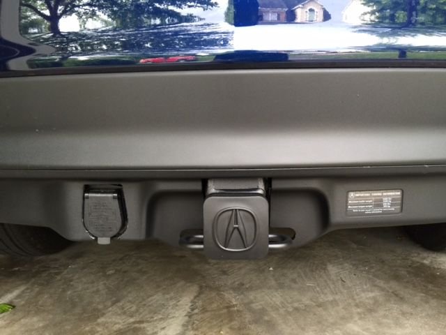

Just a quick update. Got the trailer hitch installed but it took longer than I thought (3 hours). May be I was not handy as I thought
If anyone plans to do it, I definitely recommend to have a helper. Especially when you try to mount the hitch.
Here is the obligatory picture

Everyone works at their own speed. 3 hours is not bad at all. If you had to do it again, you would get it done in half the time. Wasn't too bad to do.
