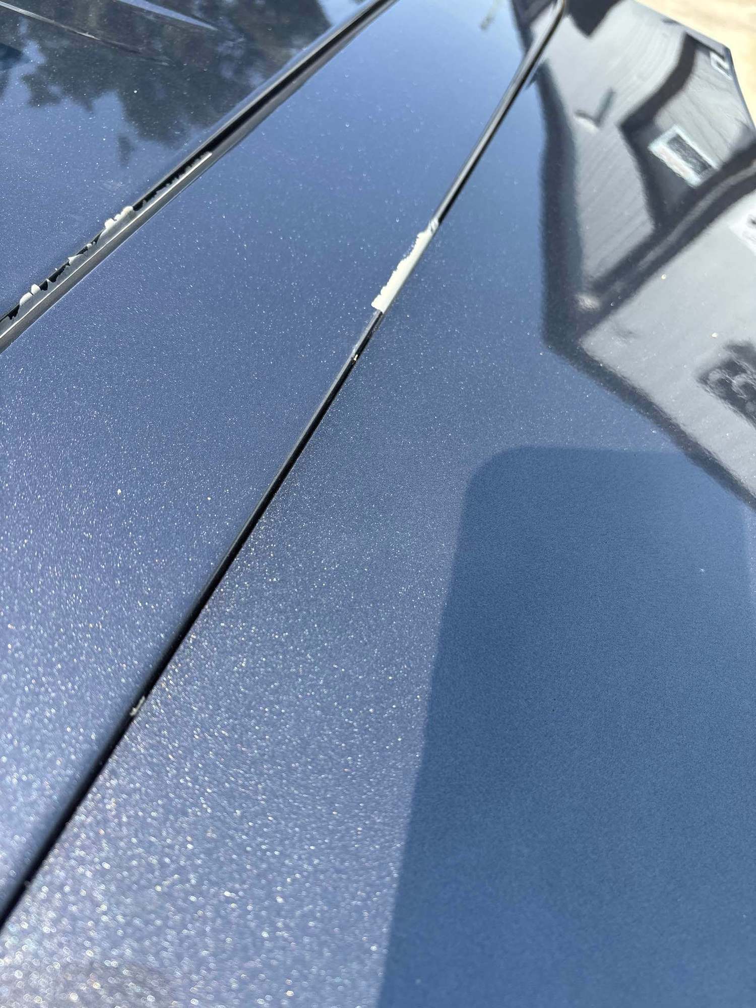

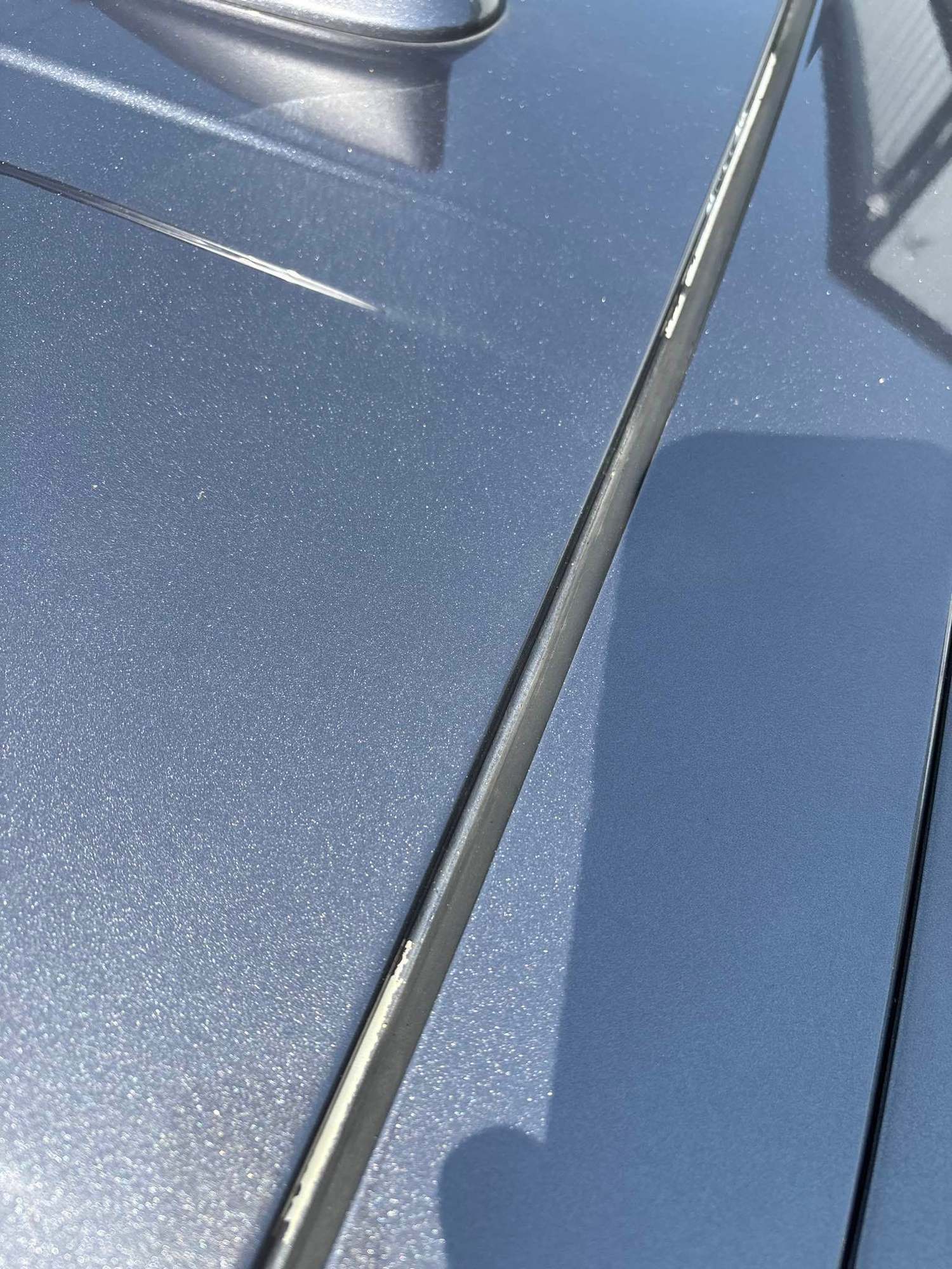

Old Jun 5, 2025 | 04:49 PM
janster's Avatar
Joined: Jun 2025
Hi, we have a 2018 MDX with the nh797m Modern Steel Metallic paint. The car is in great shape.
Recently we noticed the paint peeling from the sub coat at the edge of the roof and top of the lift gate. You can run your finger over those areas and easily remove more paint.
