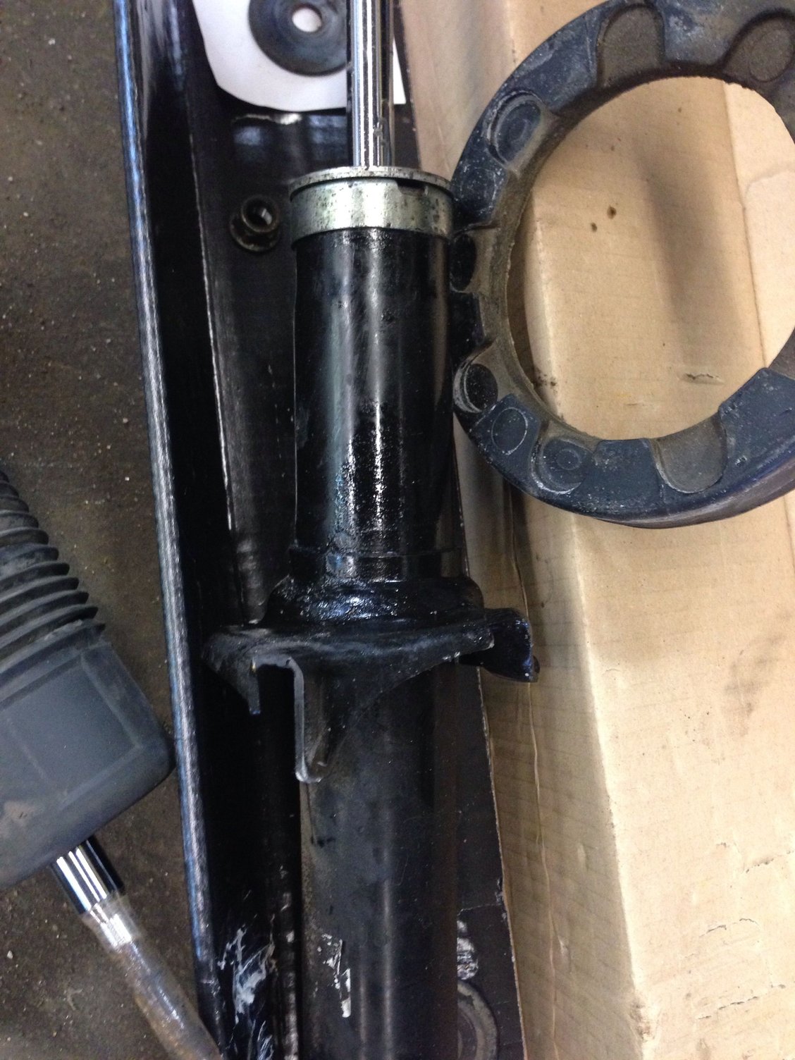

Replaced the end links on the troublesome side and the rattle/clunk was still there.
I am at the shop now getting Koni Yellows installed. Have the old shock out, and there is definitely oil on it, so must have been a blown strut.
Let's hope this is the fix.
Old May 16, 2015 | 12:07 PM
Vinny_P's Avatar
Posts: 160
Likes: 32
From: Toronto, Canada

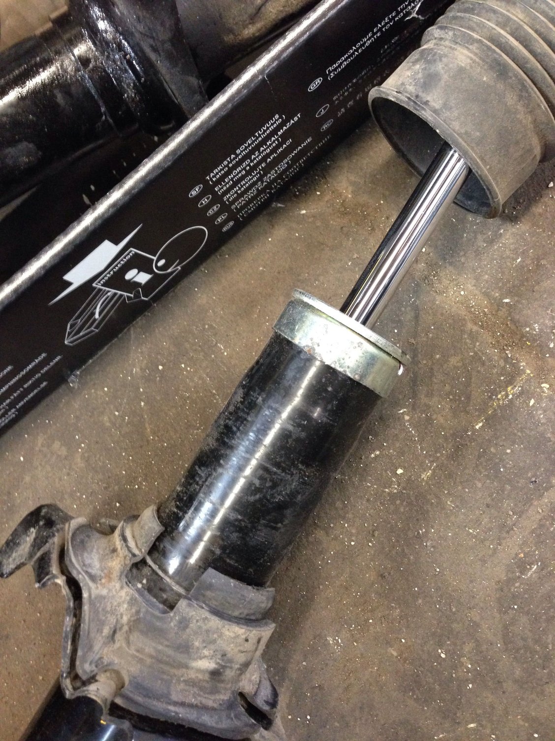

All is good, It was a blown strut.
See pics for reference
Blown Strut hydraulic fluid on the outside
TSX Blown Strut
Left From Strut, Not Blown for reference.
