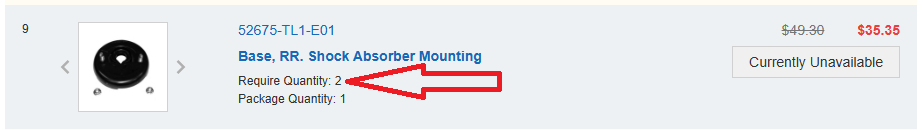

I don't know if this part is a front strut mount or rear?
1) The picture (purple) below is for the front; however,
2) the part numbers (red) indicate the rear?
Maybe go with KYB instead, though, there is no OEM 'part number' data to cross reference, lol?
