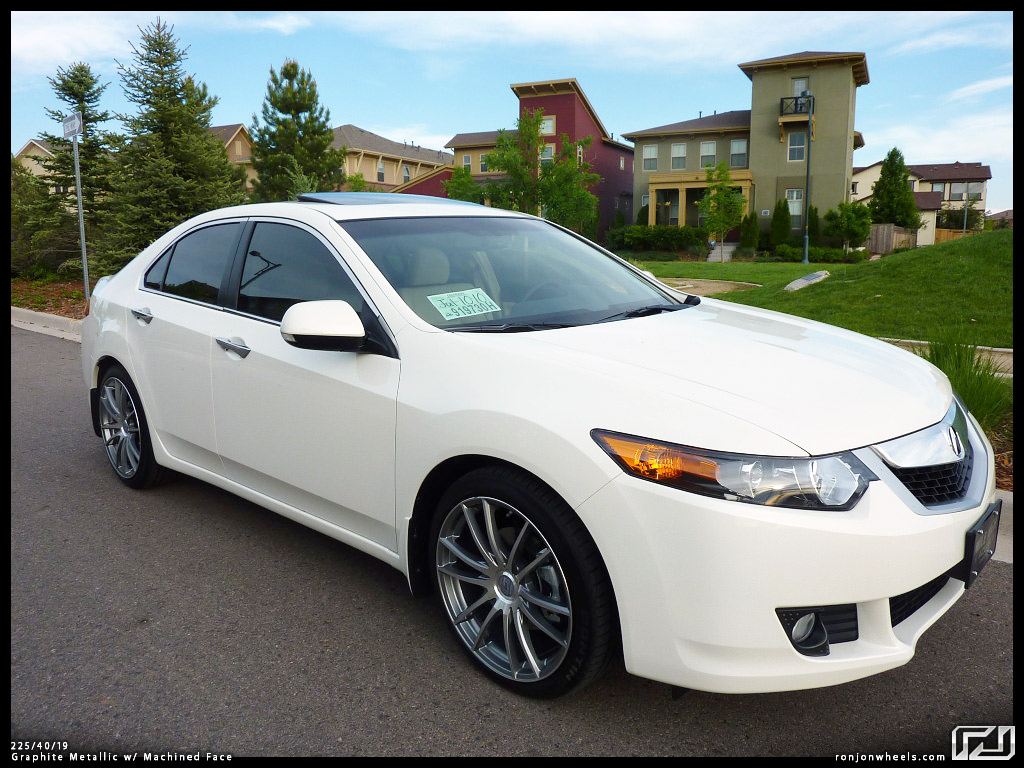

This is a pic of my current ride:

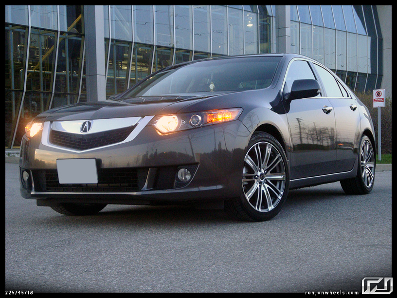

I am considering upgrading to these 18" rims:
1st question: What do you guys think?
2nd question: I currently have 18" wheels on my car, I am sure I can use the same tyres that I currently have?
3rd question: These wheels are 114.3 pcd and offset=35. Will this be fine?
I also plan to drop it with H&R springs.
Thanks for the guidance guys (I am verrry noob when it comes to wheels and tyres)

This is the other option... Just confused with the offset though, not sure what to get.
I know the tyres are 235/45/R18, I will be doing the H&R drop as well. Want it to look sweet, but dont want to have any rubbing issues. So as far as the offset goes, I really dont know what to do...

If I'm correct, the OEM offset for your V6 rims are 55. Since the rims you're looking at have an offset of 35, then the wheel will stick out 20mm further than stock (meaning further out, looking more flush with the fenders). You can actually go out and measure it to be sure.
I don't like either rim but if I had to choose I'd say the second one.
Dropping on H&R springs would give you a bit of a tucked look if you like that. I think it'd be nice on your 18's.
A more conservative drop would be Eiback prokits or Tein H-techs, both are around 1 inch settled.
