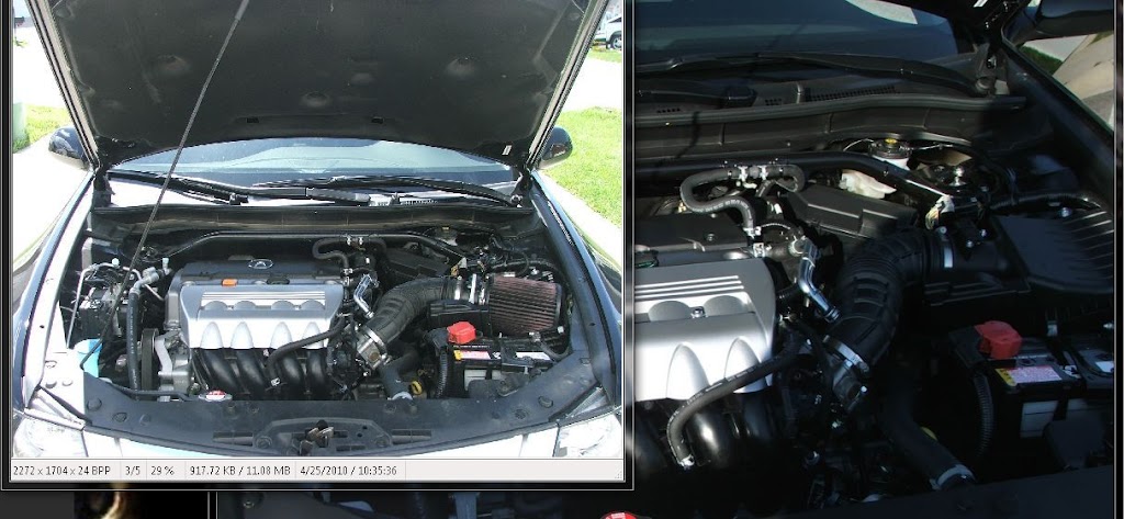

Believe it or not, this made a difference for us. We noticed the same thing comparing 08's to 09's when we were test driving them back when the 09's just came out. Simply not the same responsiveness and get up and go. We sided for the 09's because the body style simply was that much better. Massive improvement in style. Anyways, one of the early mods I did was a make my own SRI since one didn't exist yet. Adding this changed how it sounded and also how it launched. Considerably more in line with our 08 experiences.
Wife is happy as well because when she wants to make it move... it does... otherwise it sounds quite normal. All I am hoping is that someone comes out with an aftermarket 4-2-1 header and mate it to a catback.

Short Ram Intake instead of a Cold Air Intake (CAI) which usually runs down to the bumper. SRI stays in the engine bay. Since nothing was available, a little PVC piping, a few mods to support the MAF sensor, and a K&N barrel filter (large).. then remove the top of the air box and the filter and rest the new filter in the lower airbox. Here is a pic to show you what I mean :

hey bsc7080tec,
would you mind giving us clearer pictures of your sri?
i have an old AEM filter that i wouldnt mind using on my TSX.

Do these help ?

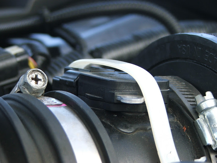

is the white tie-wrap holding the MAF sensor to your pipe?

Yes... kind of hack I know. It's a heavy duty strap. Pretty thick. It was to be temporary only, because my plan was to buy another top piece for the airbox and cut the tube from that. The PVC pipe setup was a test if this setup would even work to begin with. In the end, I found that it held just fine and the whole setup seemed to work on its own quite well. It has been since we purchased the vehicle new. I check it periodically, figuring fate may not be on my side some day... It remains intact. Even without the strap, it fits pretty snug. Now that I recall, I may have even swapped out the rubber o-ring for one that was just a tad thicker... it was a long time ago so the "how" fades away slightly. Back then it was just a grand experience with 'momma' waiting in the wings wondering what I was doing to her baby and if she would survive the upgrade. Near 2 years and 15k miles, she still is.
All that said, if anyone has recommendations of how I might be able to fabricate screw posts that will stay in place that won't protrude into the chamber, let me know. Always room for improvement needless to say.

If you didn't catch before, there is a 1 inch hole in the main pipe in which I placed a trimmed ring from the T-coupler (1 inch pvc pipe), which is a snug fit for the hole, and leaving a smaller diameter opening which was a snug fit for the maf sensor. So the maf sensor is in fact sitting on flat level surface mated with no gaps. The trimmed pvc ring rises above the main pipe...essentially the same as the stock setup. There was no appreciable loss in mileage either. We have seen 22 in town driving only, 33 mixed, and near 40 highway only. So I can only figure that whatever I did seems to be working.

Just a follow-up. I made a statement about hoping for a 4-2-1 race header for the TSX. Duh... that won't happen. The header is more or less a component of the engine itself, and almost immeadiately goes into catalytic converter. The most we could hope for is a catback exhaust aftermarket setup. Just would like to beef up the sound a bit... some of a low mellow tone.
The SRI... is still working like a charm well into 2 years later.
