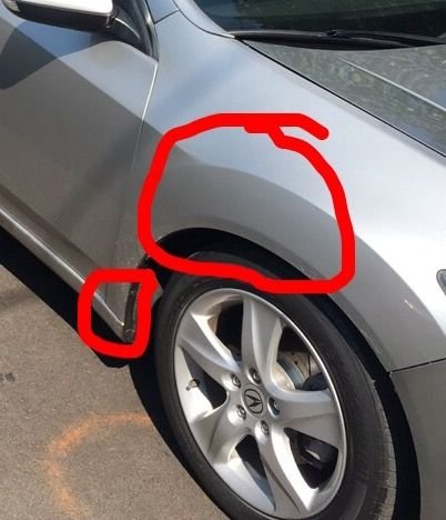

It's the actual fender and the small piece

just a quick search shows that the oem replacement fenders are over 200$ unpainted. the oem equivalent replacement on rockauto.com is about 90$ and still must be painted.
unless you can find a pair that are already painted that silver color you are looking at body shop paint/prep costs.
Another option is to see if there are any fenders from salvage yards in your area that match the color.

It's not hard, just time consuming. When installing it, don't tighten all the main bolts down until you are happy with alignment, alignment of the fender to hood will need adjustment. Measure your current hood with fender gap. That measurement will help you realign it, also note measurement of door gap with fender.

Removing the front bumper and headlight would make it easier.
