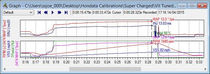

I know you don't believe me but the stock intake tube can handle it. Here is one of the red-line datalogs I took and it's very linear boost up to 12psi and no choking.
I mean you're already spending $4k so what's another ~$300 on an intake? But honestly.. I would just wait until you start tuning and the problem arises.

i believe you. It's just a question on which intake tube will collapse. For now I'm just going to delete my intake resonator, keep the k&n filter in and run a tube down behind the bumper with a velocity stack. Not to low though, don't wanna suck up water.
