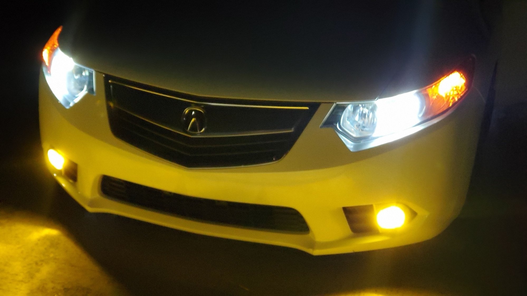

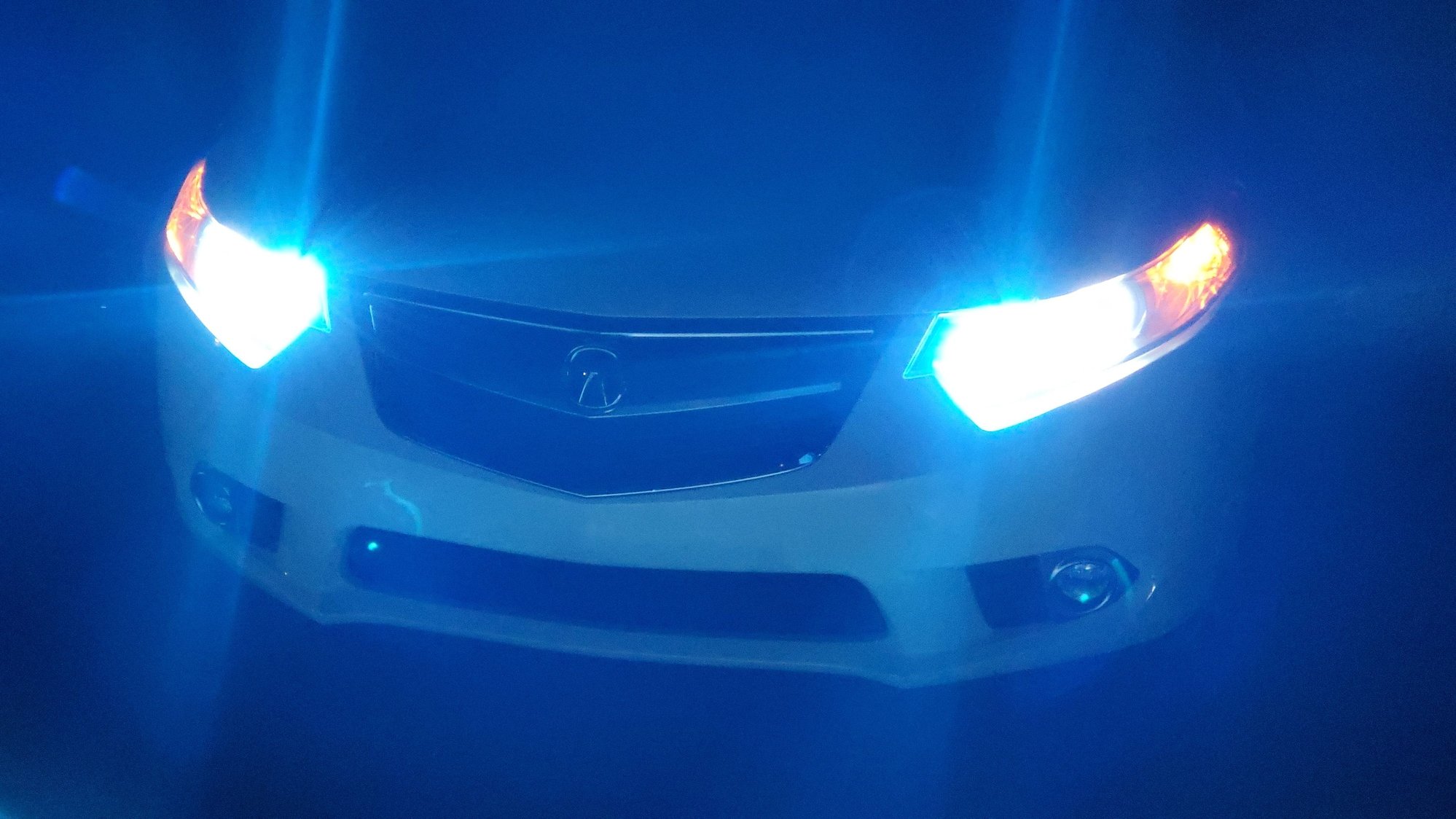

Yellow Ebay LED Fogs
9000K Ebay LED High beams

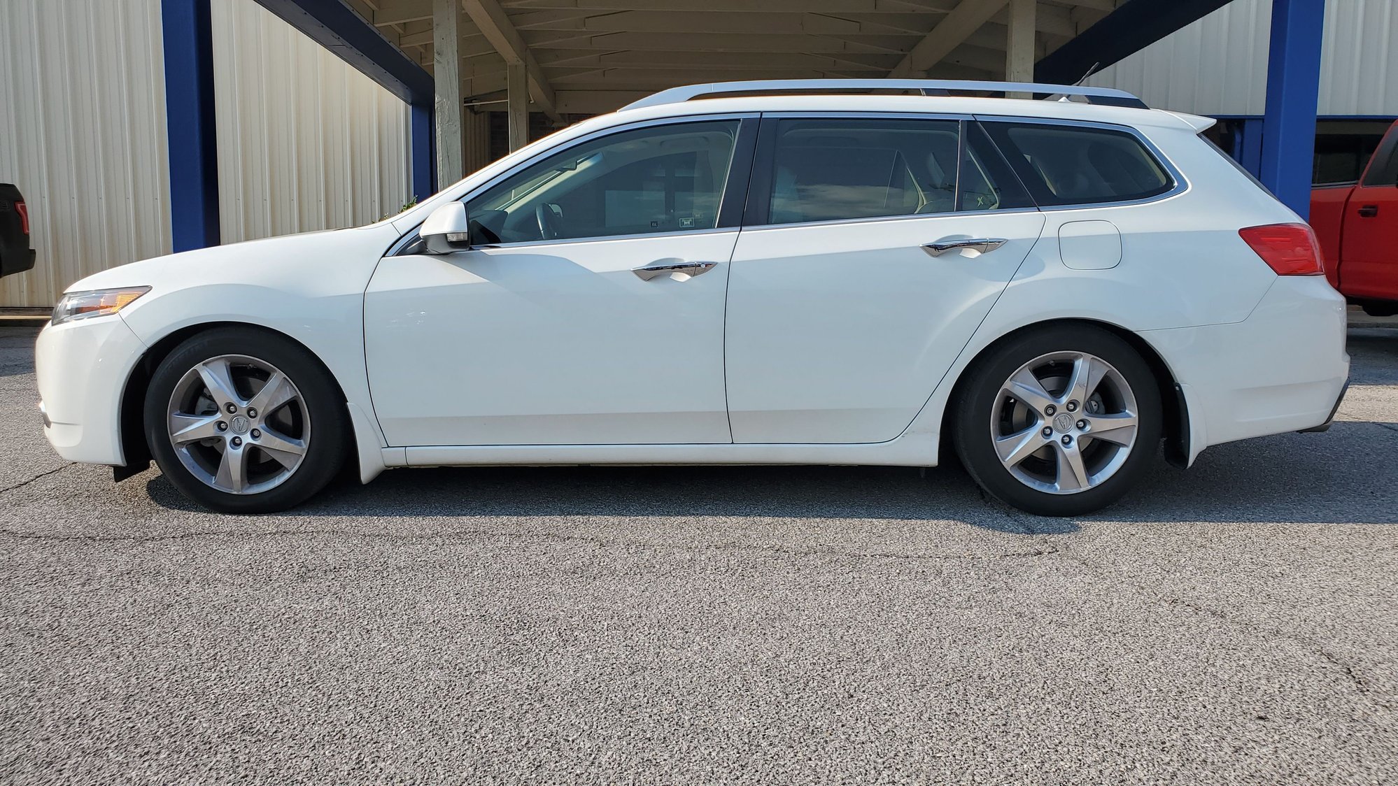

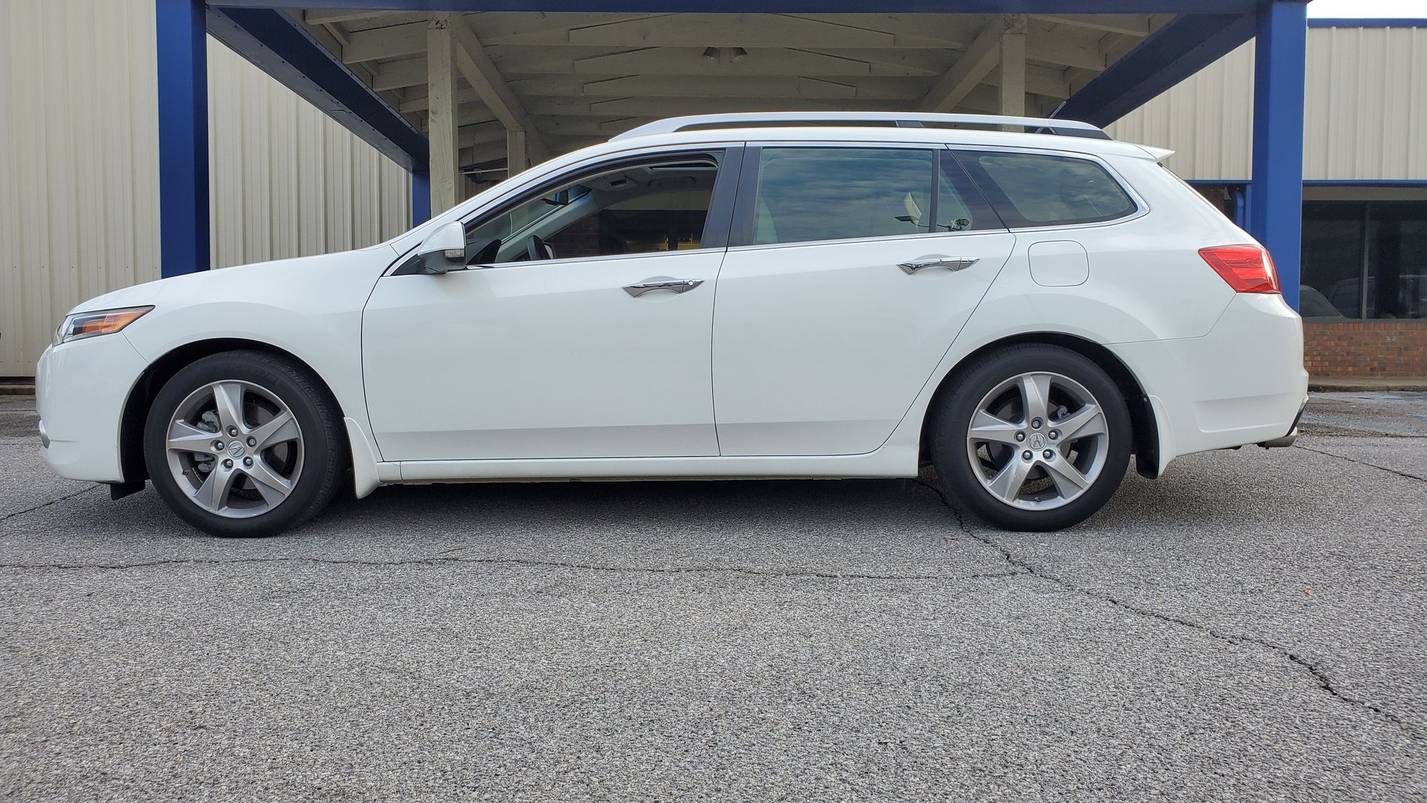

The car needs brakes, tires and I discovered my struts were leaking. It had a bit of a wallowing ride and was choppy over certain bumps. I knew I was going to lower the car, I just didn't know how or how much. I knew from the jump I didn't want to go too low because I want to get bigger wider wheels with a slightly more aggressive offset and I do NOT want to have to roll the fender wells. I'm also old, and I can't deal with having a slammed car anymore, plus I have a wife, kids and might actually want to carry stuff in the car, and I don't like to scrape everywhere. I also didn't want "coil over" ride with this car, so lowering springs were always my go to, because air ride isn't in my budget. I had KONI yellows and Eibachs on one of my DSMs and I loved it, but I didn't feel like I wanted to spend that much this time on this car. Luckily, TEIN just recently announced stock shaped replacement shocks. I got the non-adjustable kind and I got RSR Down Sus springs that are designed specifically for the wagon. I think it came out perfect. They dropped it about an inch in the front and less than an inch in the back. I just threw some cheap Autozone pads on to hold me over until I research brakes more. I want a BBK, but I also want the wheels I'm getting to fit over them and now that I know Evo brakes won't work, I need to research the whole Genesis, RL, 350Z, S2000 yadda yadda thing.
Tein EnduroPro and RS-R Sport Service Down Sus Springs
Before
After

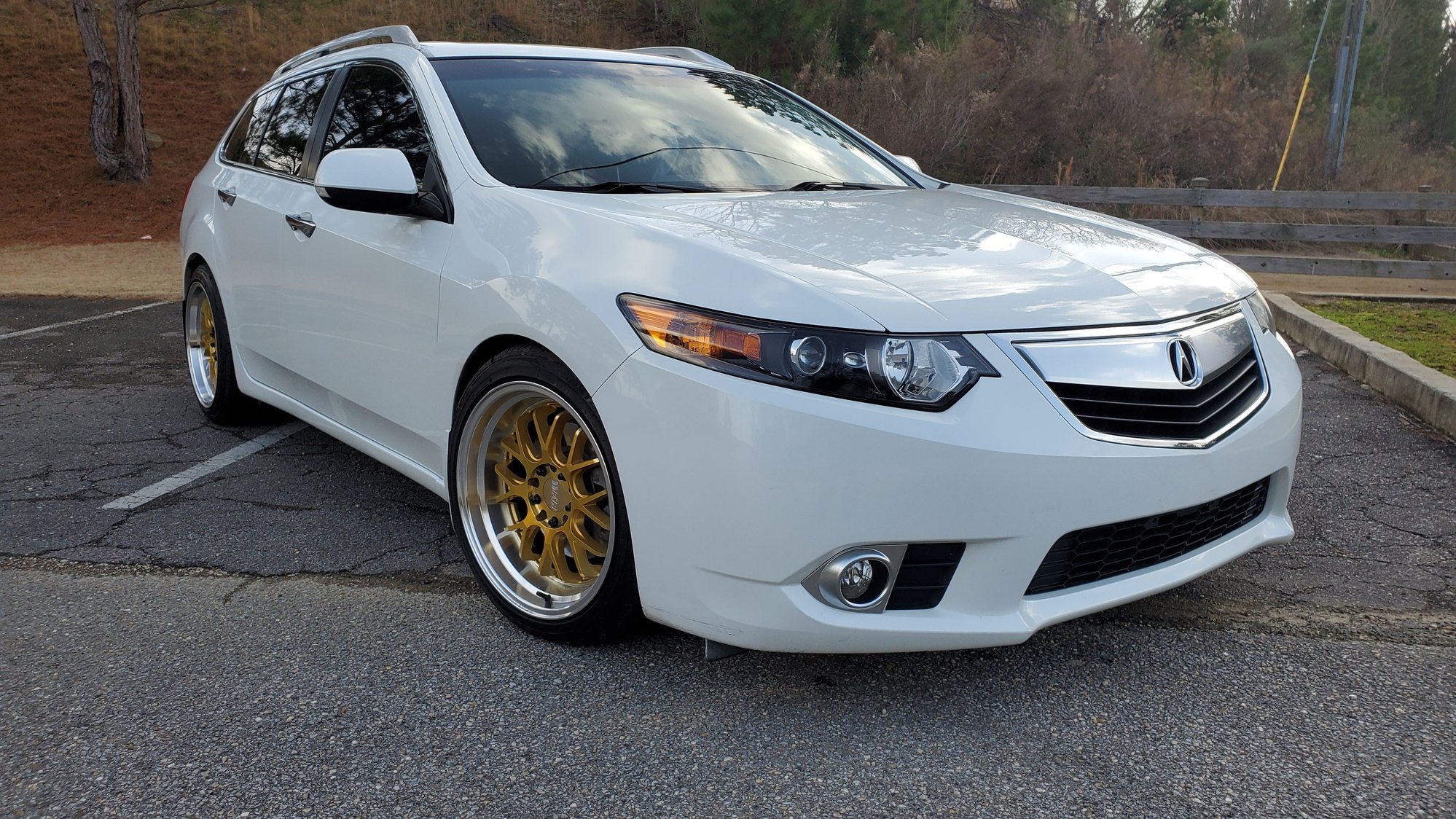

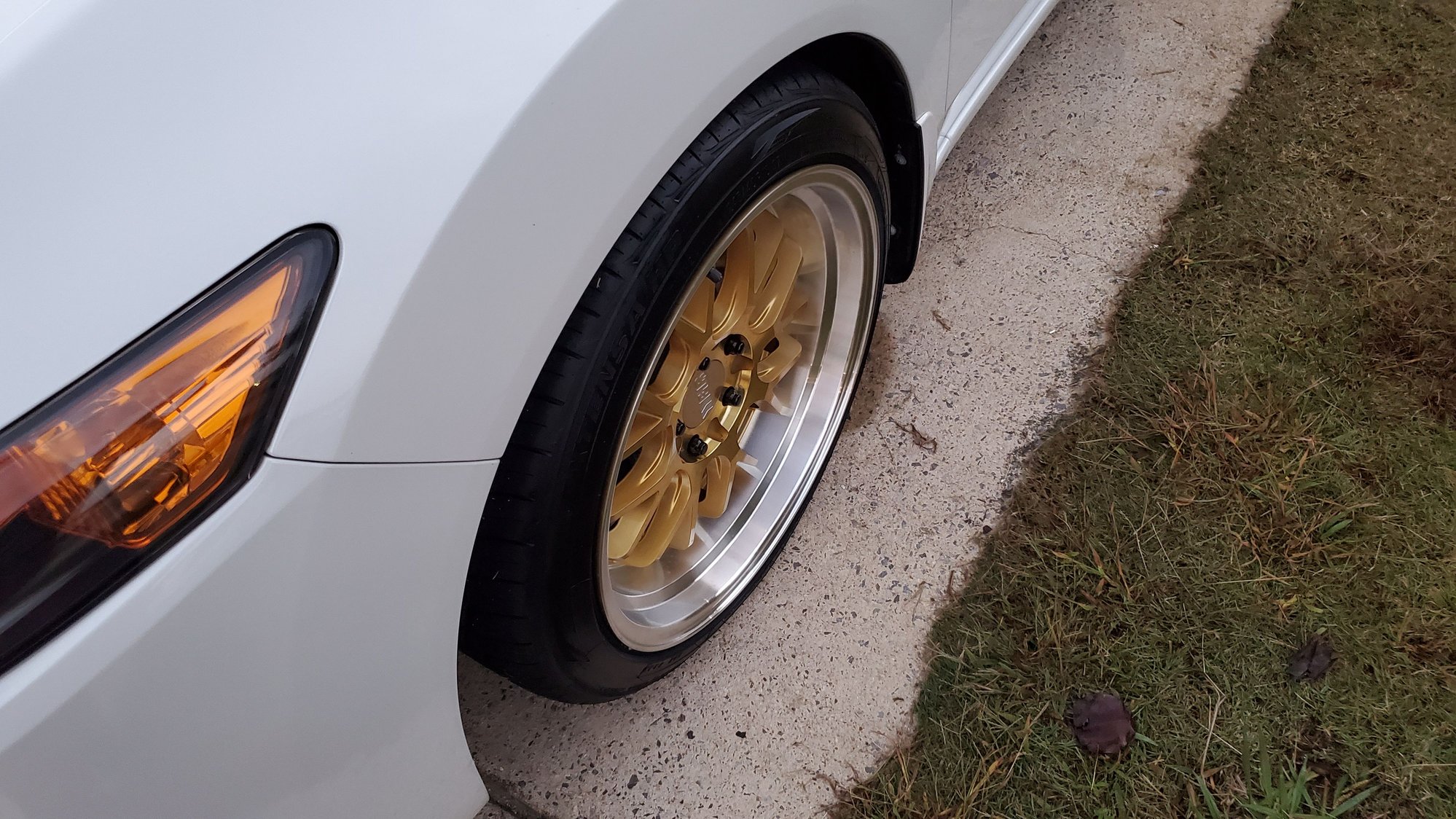

18x9.5" +40 F1R F21's Gold Machined
245-40 Toyo Extensa HP II's
I think the polished lip plus the chrome the car has matches perfectly. I even love the beak. No Honda grill swap for me.
I love the deep dish look and the size seems just right.

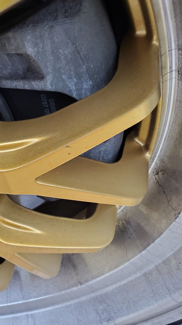

I'm glad I didn't go any lower than +40. Front wheel pokes a little. Stock brakes barely clear.
I had some gnarly bullet style lugs that didn't work, I guess this is fine.

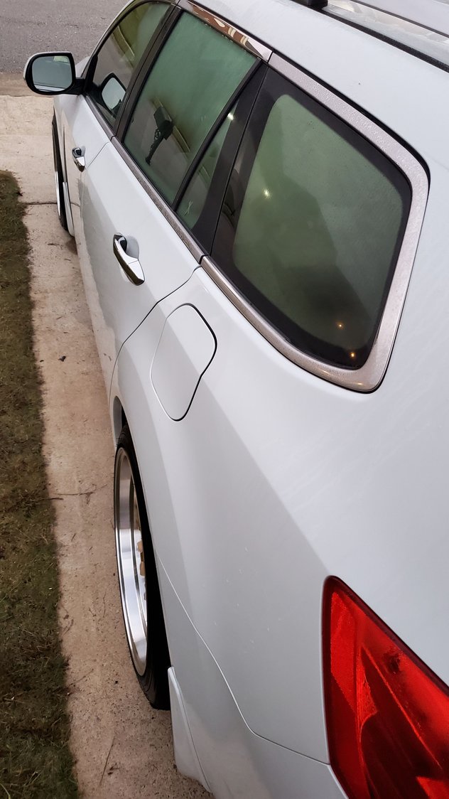

Not a whole lot has changed, I've pretty much gotten the car to where I want it to be and am focusing on my Evo. I do have a few things planned, but I won't talk about it until I'm closer to actually doing it. For now I have changed the plugs, put in a drop in K&N, debadged the rear, and tinted the windows.
I am surprised by how much attention this car has gotten me. I am really happy with how it turned out.
The "Acura" and "TSX" badges had to go.
That JDM rear bumper is calling my name, but... not now. And yeah, I know the tag doesn't fit the capability of this vehicle. It came off one of my DSMs and I didn't want to let it go.
Mesh wheels are a bitch to keep clean, but they look so good. I missed a spot, or twelve - but my back hurts so this will have to do.

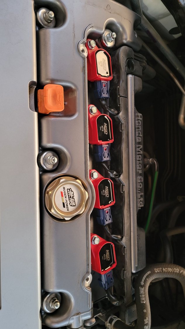

MSD coils
I added MSD coils, but I keep the cover on so I don't get the extra HP boost from them being red. I did notice a smoother idle and an 1.5MPG improvement.
Yes, i did tighten the oil cap those last few degrees to even it up right after I took this.

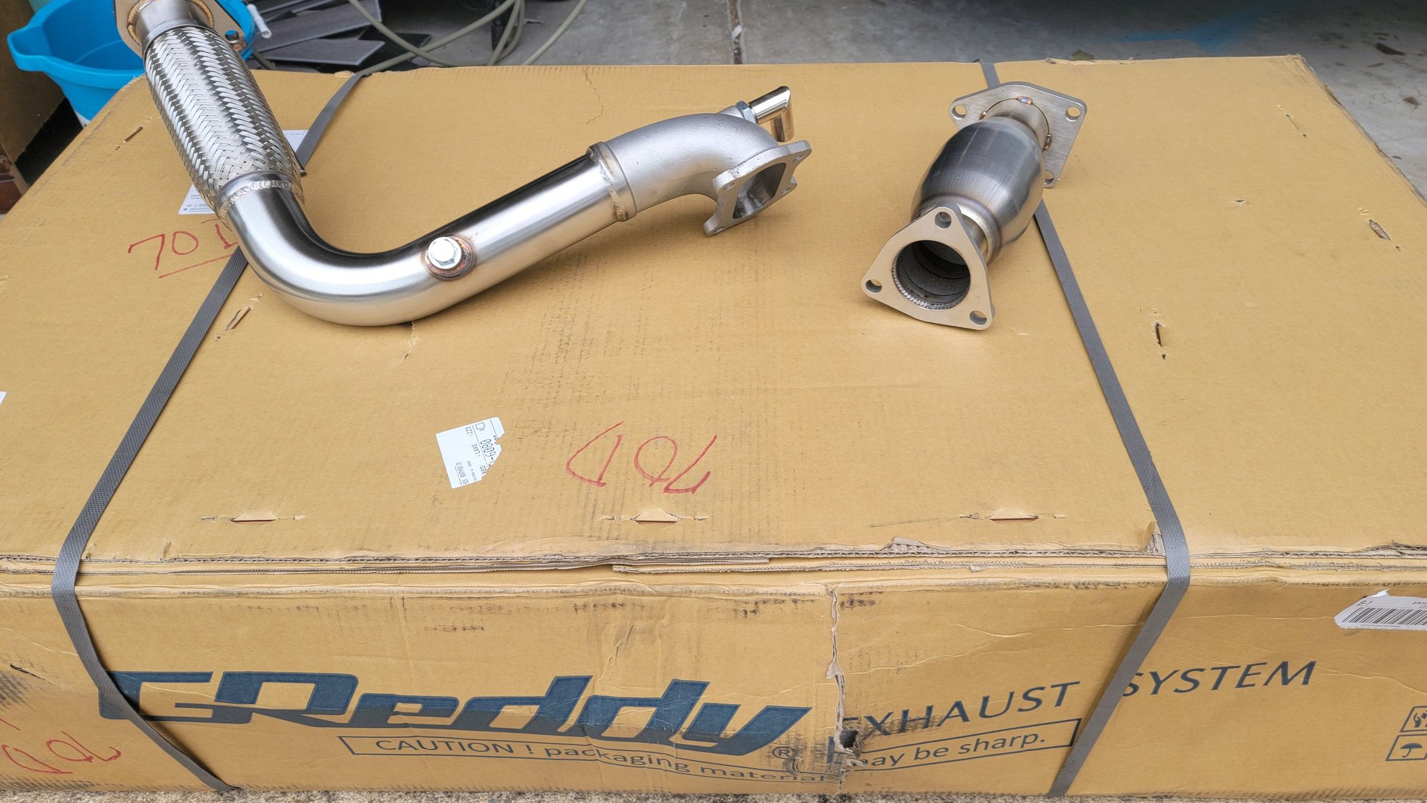

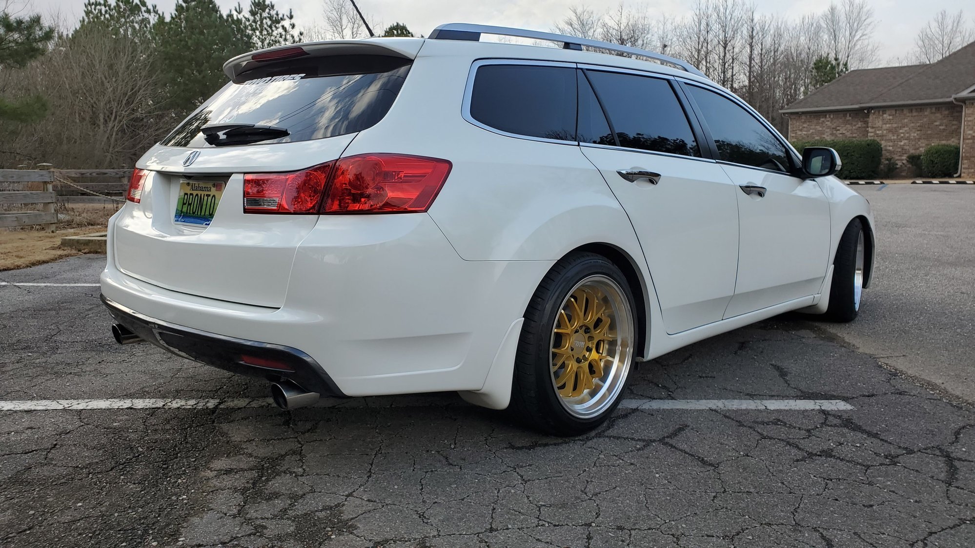

Full Exhaust
After months of waiting, my GReddy cat back finally came in. I watched all the YT vids I could and determined it was the only one I wanted. It has a nice deep smooth tone that I love. The only problem is... it is as loud as I want it to be and I am afraid if I install the DP and HFC it will take me over my comfort threshold.
RV6 was discontinued and Skunk2 had too many bad reviews so PLM it is.
Yes it comes up short like all the others on a wagon.

Nice! My Greddy exhaust just came in today and I'm hoping I can get it installed this weekend. I've already got the RV6 dp & hi-flo cat with a custom cat back currently on my car. I decided to change to the Greddy so the full exhaust had a consistent pipe diameter up until the Y split. The custom cat back is slightly smaller in size because it still utilizes the OEM resonator in addition with a Vibrant resonator and Magnaflow mufflers. I don't know your noise preference but I wouldn't consider my current setup anywhere near unbearable and wouldn't expect the Greddy to go into that realm either. Once I'm into VTEC, the Injen intake noise (cold air config) is more prominent than the exhaust is.
If you haven't already gotten a Flashpro, I would highly suggest doing so and then getting tuned as it will wake up the motor and also quiet the exhaust down compared to running the stock tune with a full exhaust. Just got done getting an E-tune from E-tunez.com and I couldn't recommend them enough. Once the exhaust is on and I grab a CT icebox to replace the Injen I'm going to get it retuned and have the VTC adjusted as well. The car is currently so much more enjoyable to drive now compared to the stock tune and doesn't feel like a dog driving around town, especially when the A/C is on. My only other engine mods are the MSD coils like yours and a Fluidampr crank pulley.
Also, how short is the Greddy exhaust from the rear bumper? Doesn't too bad from your pic but that's also not the best angle to illustrate.

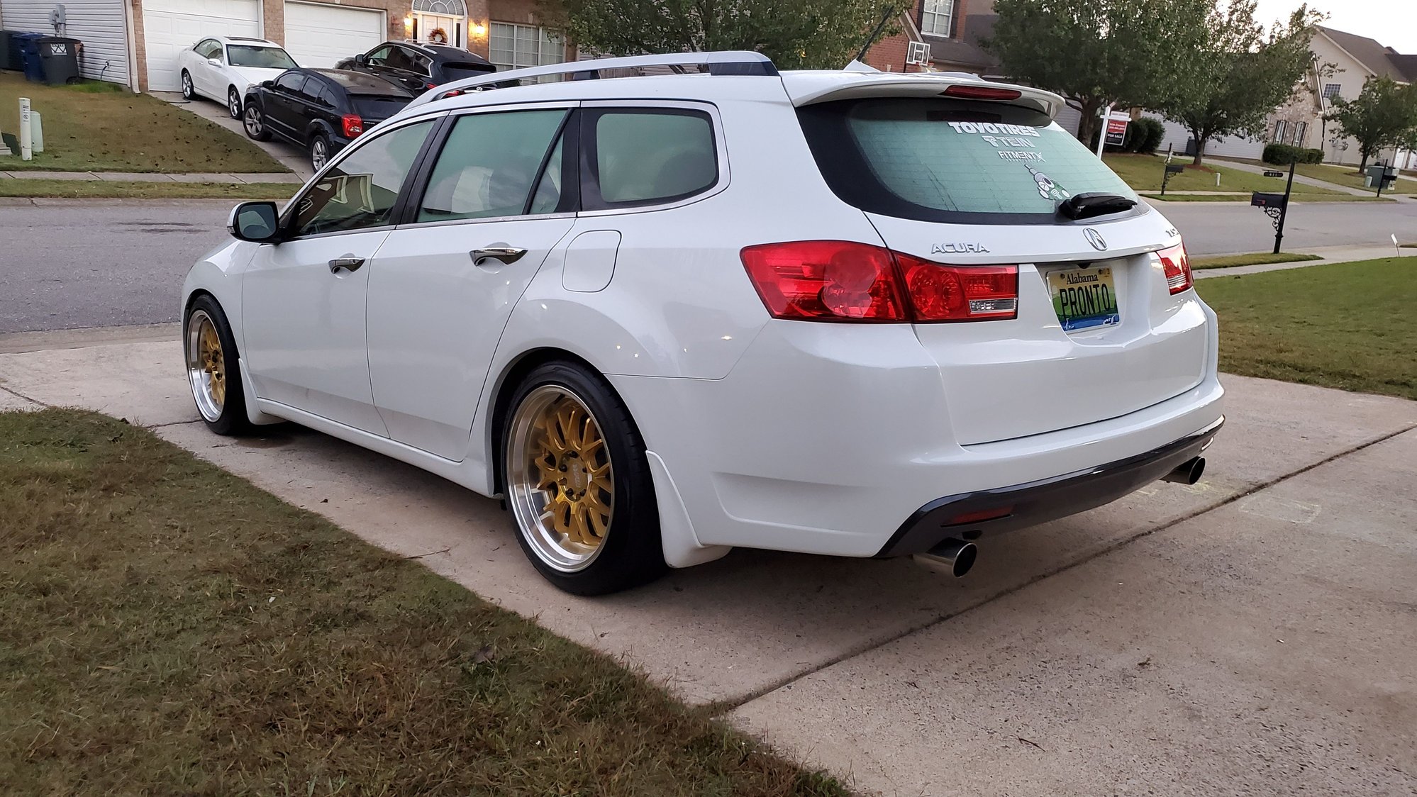

My plan was to eventually do a CT Icebox and get it tuned with Hondata. I hope it is worth the premium over a traditional tube and filter style intake. I like the looks of it and it's stockish appearance. I looked into the Fluidampr but I was worried it was only for 2010s and back... but maybe they just haven't updated their site.
I want to get a JDM rear. One of the other members has it with the GReddy it looks like the rear bumper has a more recessed lower valance that lets the tips sit in the right spot.
A better look at the placement with the USDM rear.
304 Stainless is beautiful.
Great craftmanship. It was worth the wait.

So, the PLM DP is on as well as the RV6 HFC... and a CEL as well. I didn't use the top elbow, but I'm not sure if it would fool the emissions system anyway. I would think backing the 2nd O2 sensor would do that, but there's no provision for that. I was expecting that so it isn't a crisis, but I am hoping to come up with a solution eventually. I do plan on getting Hondata, so hopefully it can be disabled.
Old Aug 8, 2022 | 05:15 PM
DoctorDaveTSX's Avatar
Joined: Jul 2020
Posts: 49
Likes: 28
From: Indianapolis, IN
The elbow should be used for the secondary O2 and eliminate the CEL. I didn't notice it before but it seems odd that it came installed in the primary O2 location since that sensor location is before the primary cat on any OEM or aftermarket pipe and doesn't need a defouler. Does the elbow not fit in the port that's plugged in your pic of the dp? That's where the elbow is installed on my RV6 dp.

Ahh, that makes sense. I will take a look and see about putting the elbow downstream. It came shipped that way... so... ahh, nevermind.
Everything got a little louder and maybe the tone changed just a bit higher pitched, but otherwise no major change in volume or tone and no introduction of any tinny or raspy elements.
I wasn't crazy about the bare JDM rear bumper either, but I was also looking to add side skirts and get rid of my mudflaps and see about bumper extensions for the rear and A-spec fangs for the front if I can find any.
