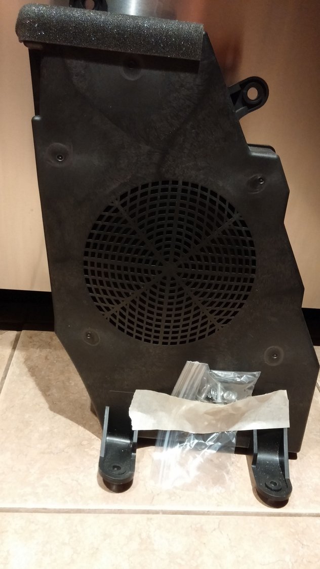

what size is the stock sub? any recommendations for a free air sub?
will i be able to fit this in factory location, with factory amp?

I can only speak for wagon but it was an 8 inch sub in an enclosure (see above pic) so the answer is going to be no. Many have tried but to no avail. Free air is a great idea and there are some that operate in this application a lot better than others so choose wisely and remember that it will still require more power than the OEM amplifier can put out to achieve the sound upgrade you are looking for.
